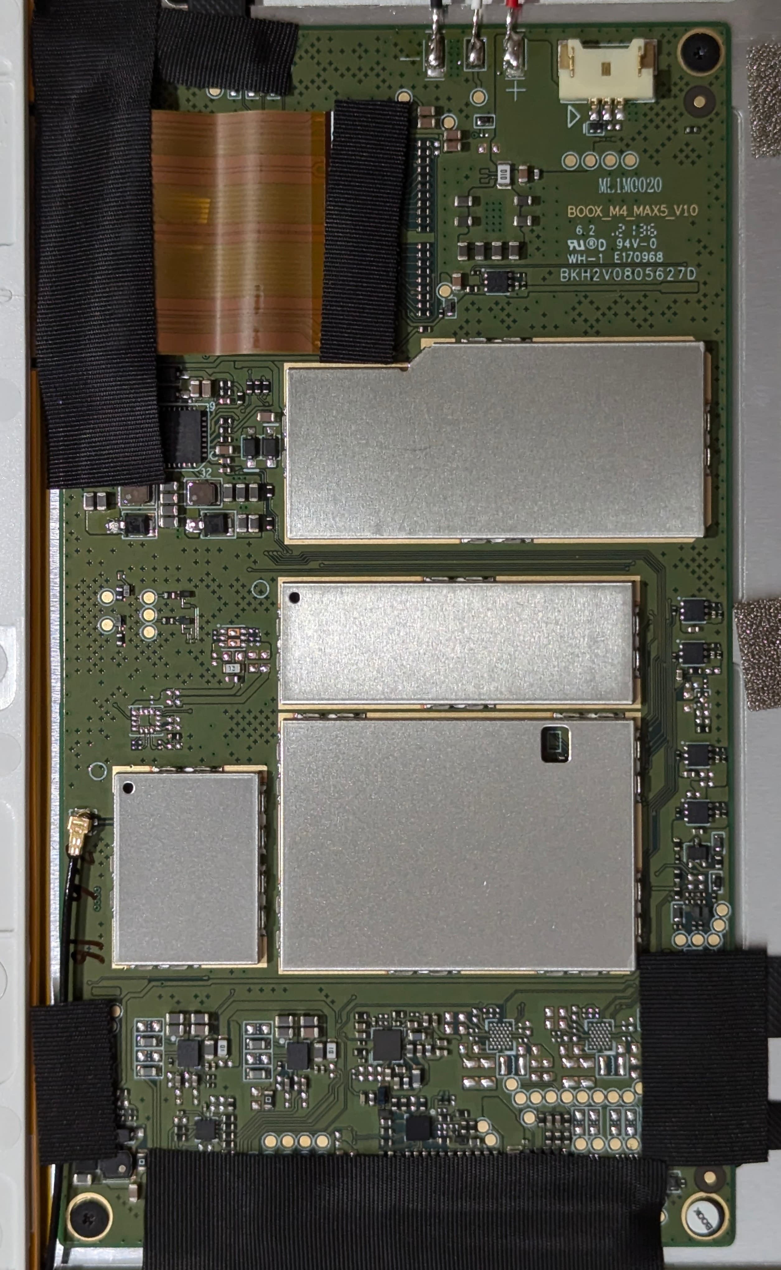

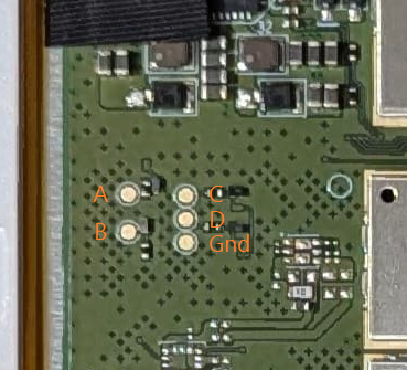

Old 10-12-2024, 12:30 AM   #28
richard.black
richard.black began at the beginning.
Posts: 97
Join Date: Sep 2024
Device: Max Lumi 2
Hey!
Here are the photos of my Max Lumi 2.
Do you have a DVM? With "Diode test"?
Yes
ID:	211355   Click image for larger version
richard.black is offline   Reply With Quote
Old 10-12-2024, 05:49 AM   #29
Renate
Onyx-maniac
Posts: 4,314
Karma: 20532355
Well, it seems obvious enough.
C, D, Gnd are your UART. Whichever C or D measures 1.8V is TX, the other is RX.
A, B are your EDL test points.
Normally (and only if I am right) could you short them together.
It's better to play safe.
Measure the voltage, one is 1.8V the other is 0V.
Put your DVM in diode test, black to a "sardine can", red to the 0V A or B, long power button press with USB connected.
Old 10-18-2024, 06:41 AM   #30
richard.black
Posts: 97
Join Date: Sep 2024
Device: Max Lumi 2
Hey!
I need your help here. On my device,
A 1.8V
B 0V
C 0V
D 1.8V
The device isn't going to EDL mode, maybe because I didn't quite understand what you meant. Could you elaborate?
Thanks
