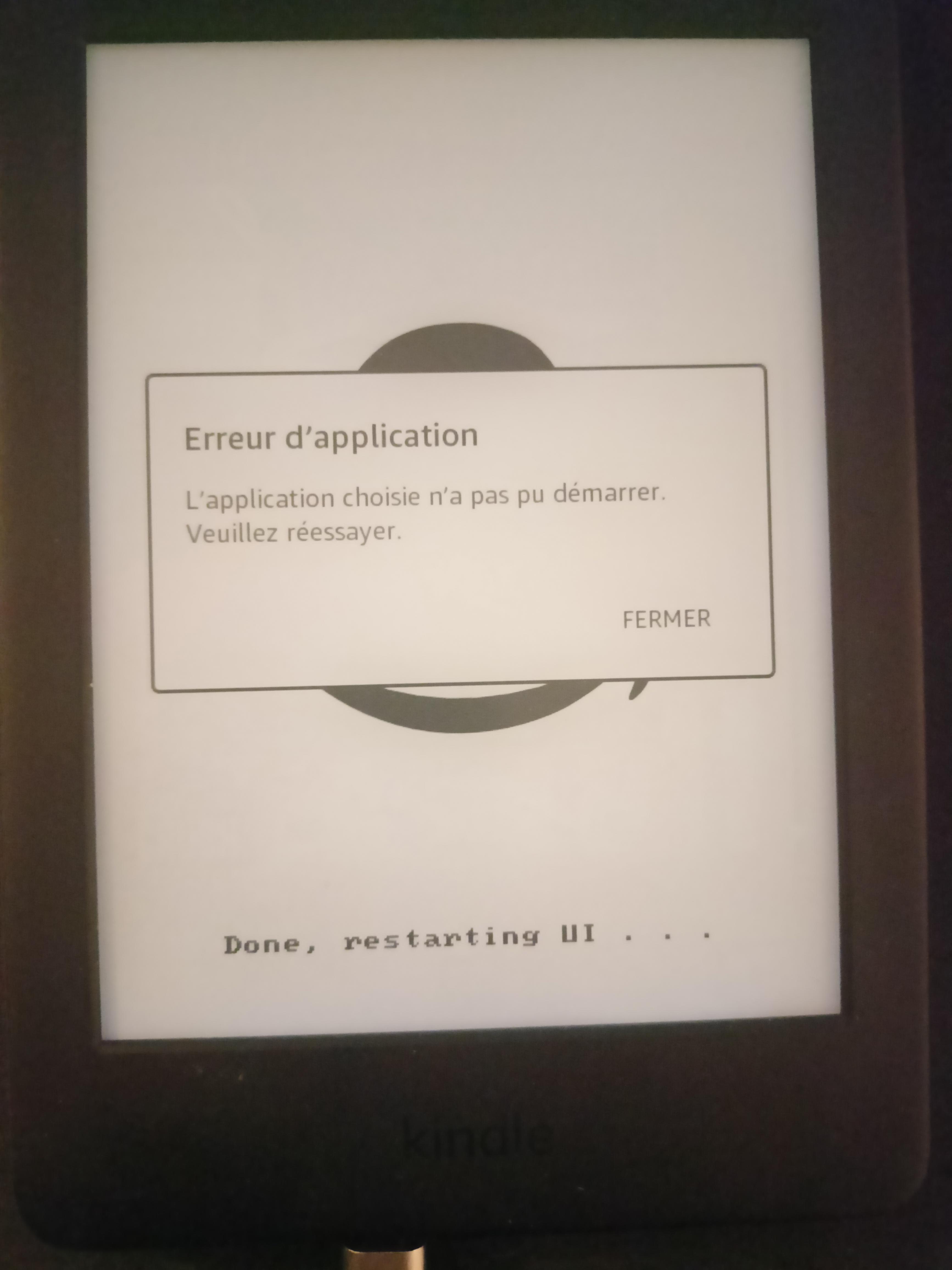

PW4 with WinterBreak. Trying to install KUAL, but the MRPI logs say:
Package 'Update_KUALBooklet_v2.7.35_install.bin' (KUALBooklet v2.7.35 I) is not targeting your device [366 vs. 11

You should be using the coplate variant on a PW4 (or basically anything that isn't over 7 years old).
I think you may have mixed up the links for KUAL and KUAL (coplate) in the OP post. KUAL (coplate) links to the 2.7.35 one and KUAL links to the one with the git ref.
Assuming the instructions I'm reading from somewhere are right

Seconding this. Using the link for KUAL coplate only resulted in this
while when I read this post and finally tried the "wrong" one, I finally got KUAL in my library. I haven't done any jailbreaking for kindle in donkey's years, and this is my first post as I registerd to reply here. If I have done anything wrong, please let me know. Also, I really appreiciate the dilligent work of NiLuJe
Relevant log entry for this install:
[2025-01-03 @ 09:30:36 +0100] :: [MRPI r19303] - Beginning the processing of package 'Update_KUALBooklet_18b218e_install.bin' (KUALBooklet 18b218e I) . . .
Extracting update package 'Update_KUALBooklet_18b218e_install.bin' to '/var/tmp/mrpi/staging'.

Old 01-05-2025, 06:53 PM   #1258
S3i
S3i began at the beginning.
Posts: 3
Join Date: Jan 2025
Hello,
first of all, thank you for all your work!
I followed the procedure on this site:
https://kindlemodding.org/jailbreaki...ling-kual-mrpi
The “winterbreak” and “Post jailbreak: Setting up a hotfix” parts went well.
But for the part “Post jailbreak : installing KUAL/MRPI” at the line “5 Enter ;log mrpi into the search bar and click enter” I have an error at reboot see picture 1.
I've tried troubleshooting and then restarting at step 5, but the same error.
I went as far as installing KOreader but it doesn't launch.
My kindle is a V10 in 5.17.1
Can you please help me?
Translated with DeepL.com (free version)
S3i is offline   Reply With Quote
