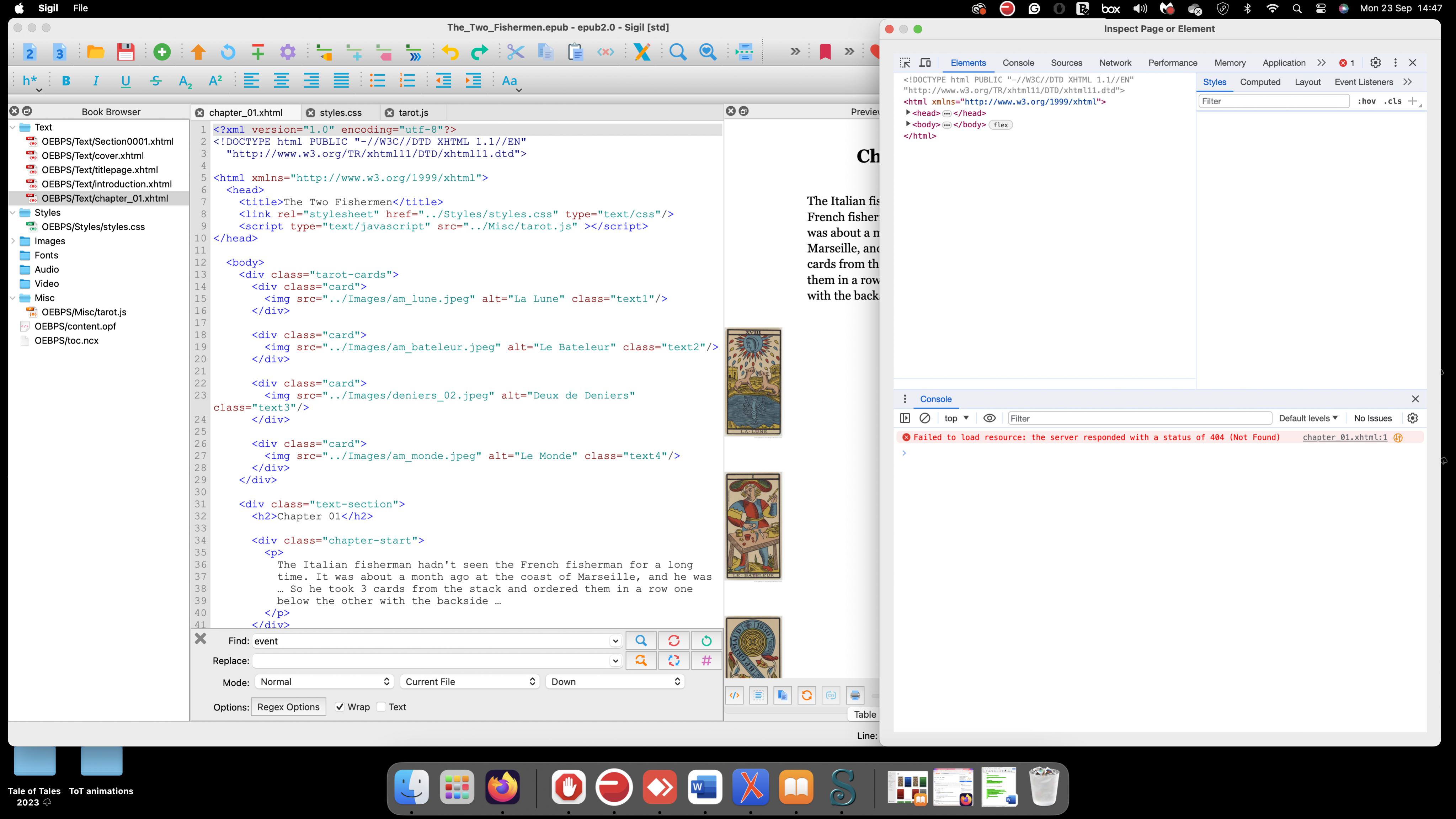

Name:	failed to load resource.jpg
ID:	210963   Click image for larger version

Old 09-23-2024, 07:02 PM   #4
Posts: 50,744
Karma: 178402706
One item that may be causing issues is that you are creating an ePub2 document and JavaScript support was added in ePub3.

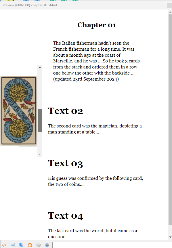

After using Sigil's ePub2 to ePub3 conversion tool and correcting the vh15 to 15vh, it does seem to work in Sigil's preview window and Thorium but the card size seems rather small. I ended up increasing to 25% and 40vh in the CSS style.
I've attached an image from Sigil's preview screen of what I see.
Name:	Screenshot 2024-09-23 210022.png

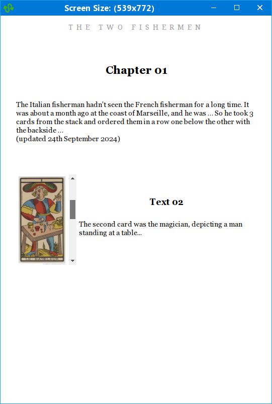

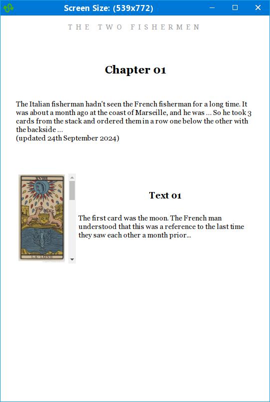

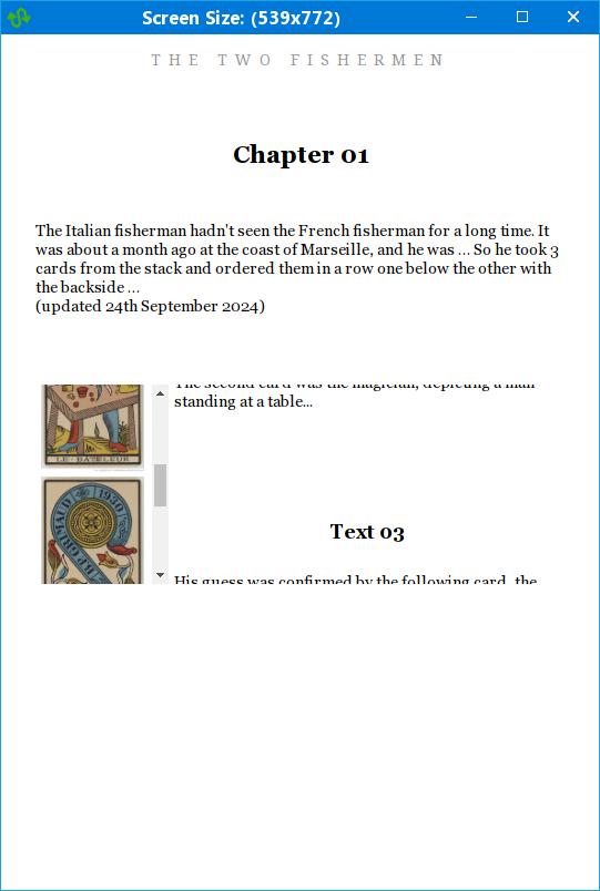

This is an epub3 (with only the chapter_01.xhtml file in sake of simplicity), that shows an alternative method to do the things.
ID:	210980Click image for larger version
ID:	210981Click image for larger version
ID:	210982Click image for larger version
ID:	210983Click image for larger version

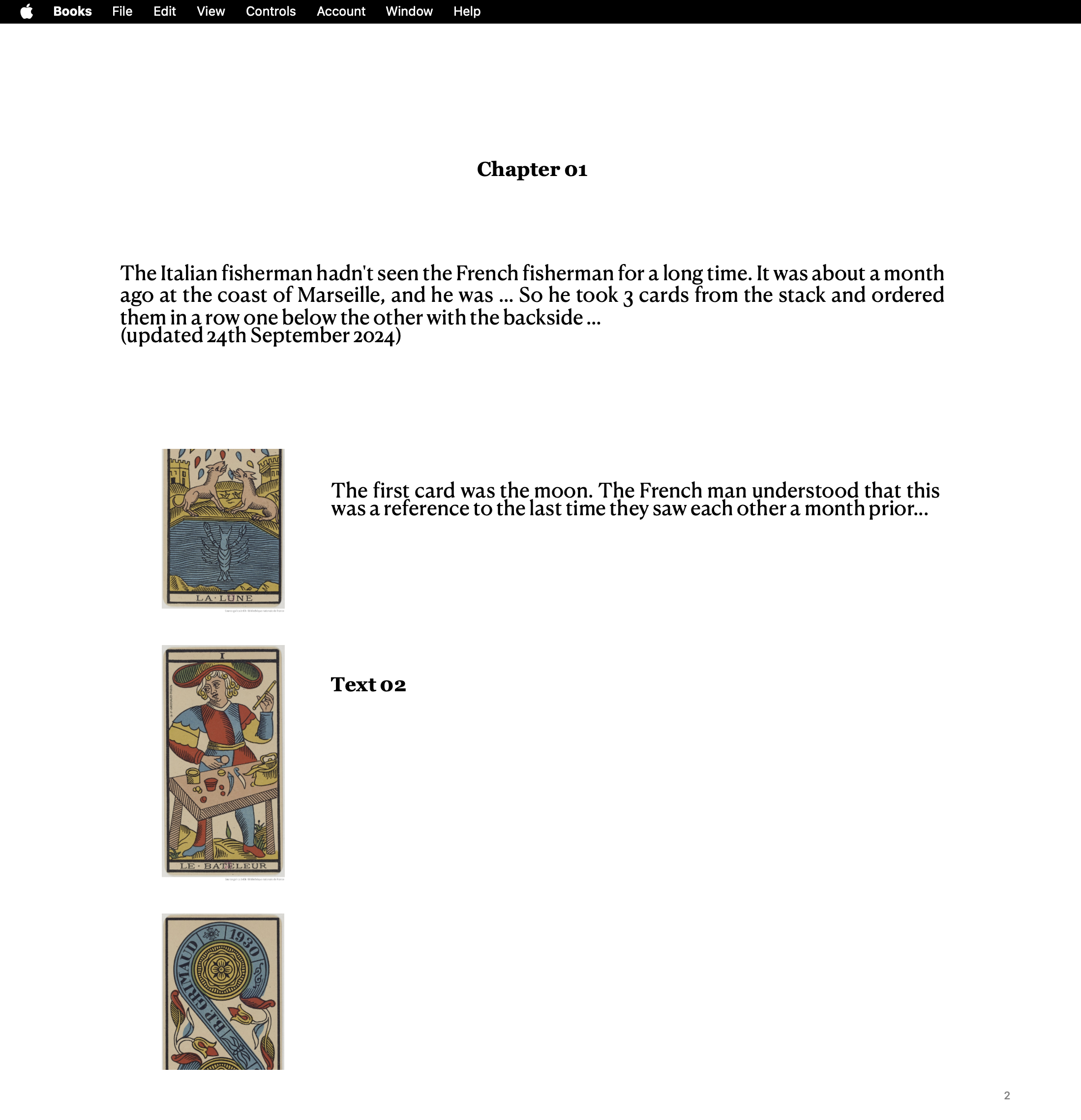

Bummer! I didn't see that it's epub.02
Where is the format converter in Sigil?
I modified my files. It's working now.
I am just struggling with the scrolling.
It stops after the second card.
Many thanks!

The method you employed needs more tunning to be implemented on epub; it can work fine on web pages but on epubs you also.would need to add a sync between the two scrolling. Watch the alternative method I posted, that works fine on epubs, and also sync the scrolling of the cards and the asociated text. Because of the sync, you don't need to hide text.
To convert an epub2 to epub3 in Sigil you need to install the epub3-itizer plugin.
https://www.mobileread.com/forums/sh....php?p=2973066
