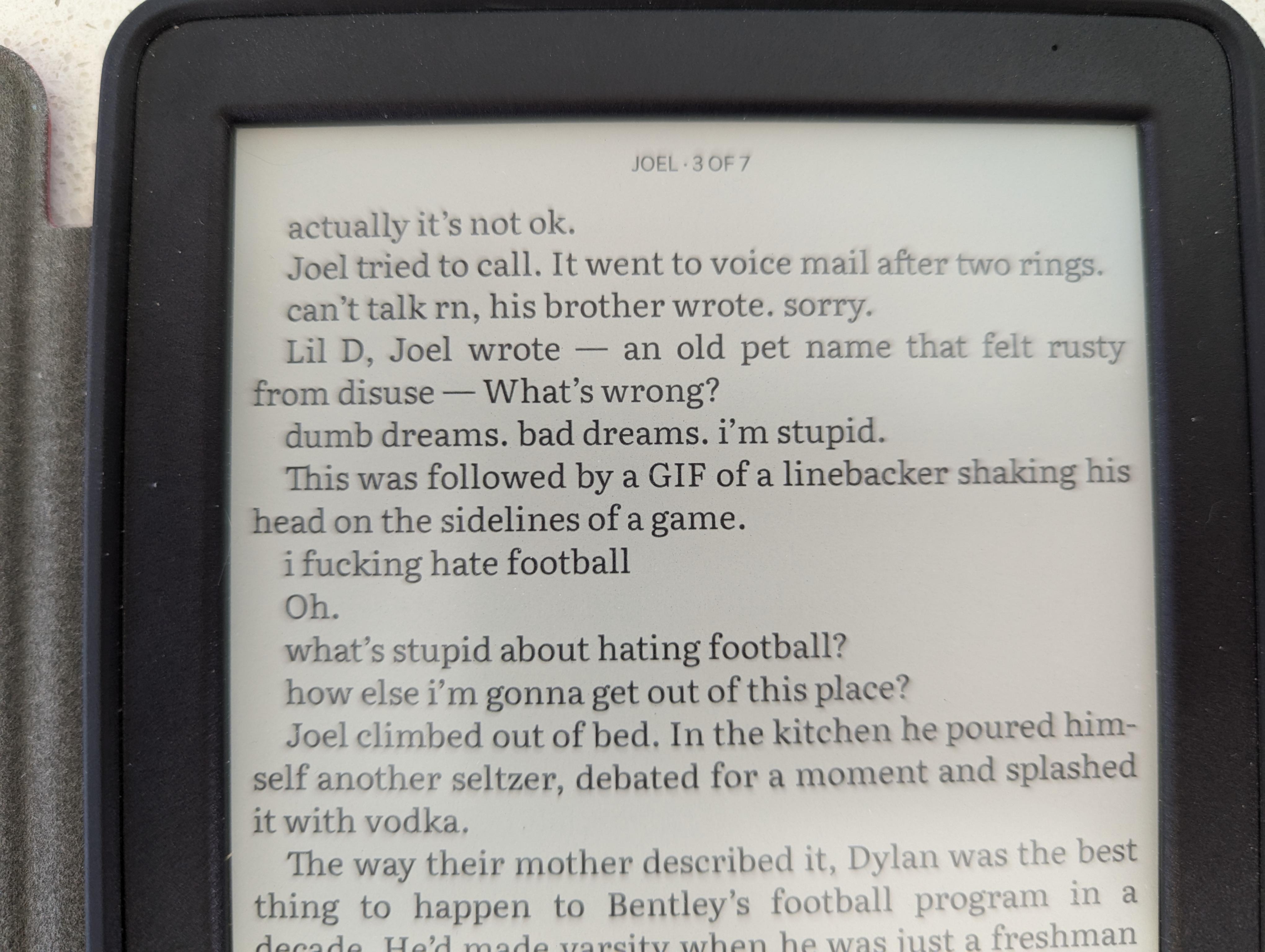

I'm reading a book (The Bright Lands by John Fram) that has a lot of text messages and emails that are supposed to display as sans serif, but Kobo seems to be ignoring that.
I've attached a picture of Nickle displaying the text.
Here is the code from the book:

Dumb question but is the font setting on the device "Publisher Default"? If not I believe all fonts in the book will be overridden.

Are you reading EPUB or KEPUB? Unless you select the publisher's font on KEPUB, your chosen font gets used for everything, and all font changes in the CSS get ignored.
Nope. And changing that fixed it. I don't like that setting for kepub. I would prefer changing the font to just change the body text, But calls for special cases should be respected.

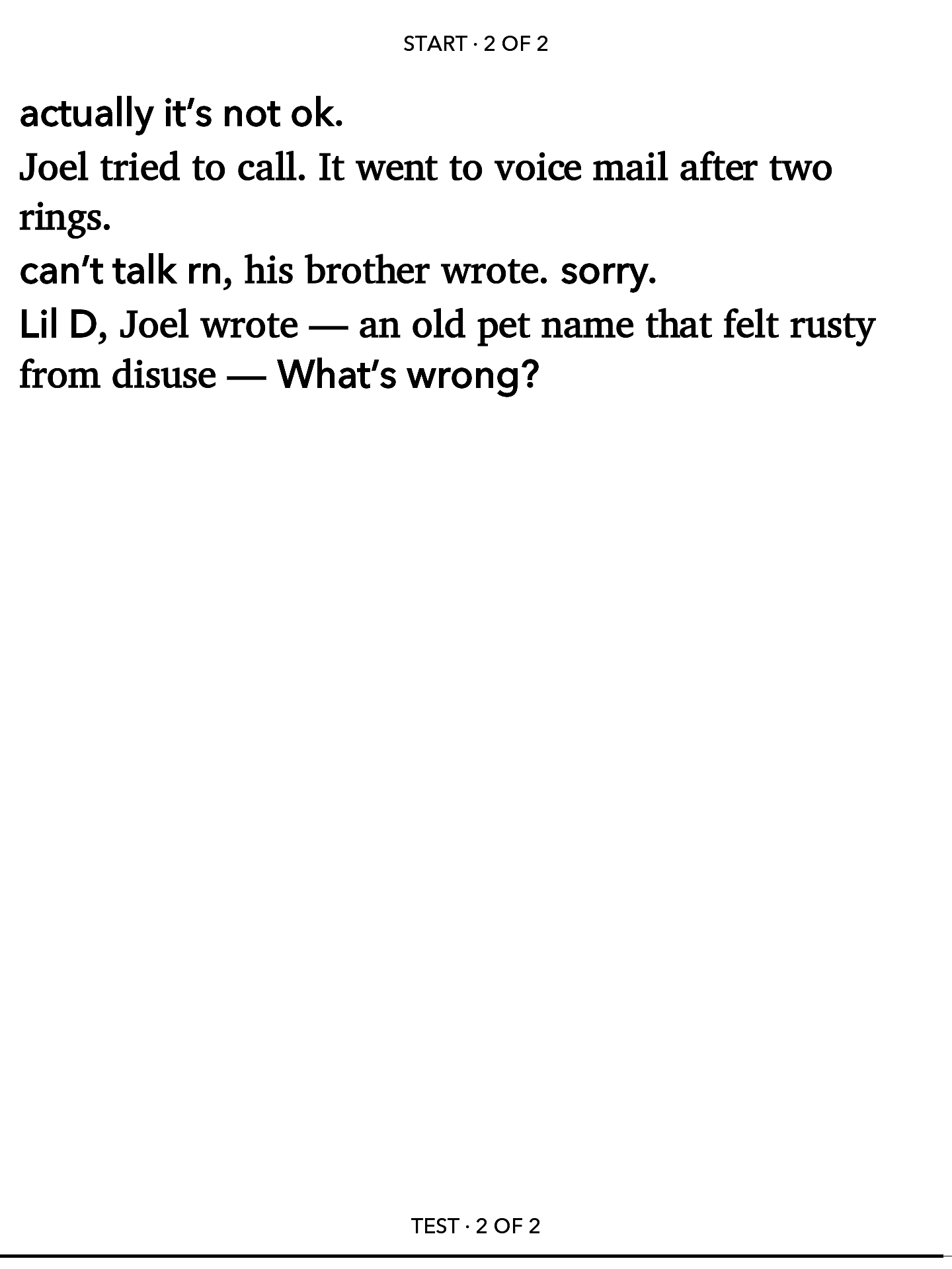

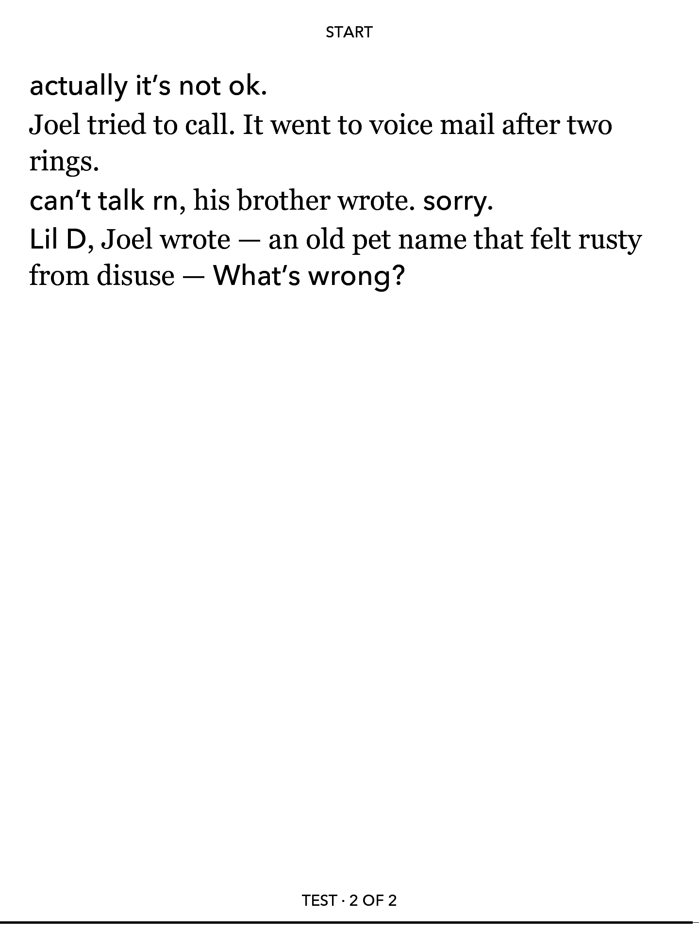

I took a quick look at your book but did not see where you used an @fontface to link the font in the fonts directory to your ebook. I haven't tried that in a while but did remember having to do this a few years back.
I tried this and epub had not issue while kepub did require publisher default to show the alternate font. I've attached the epub with the @fontface bits and a couple of screenshots (1st is the epub, 2nd is the kepub).
