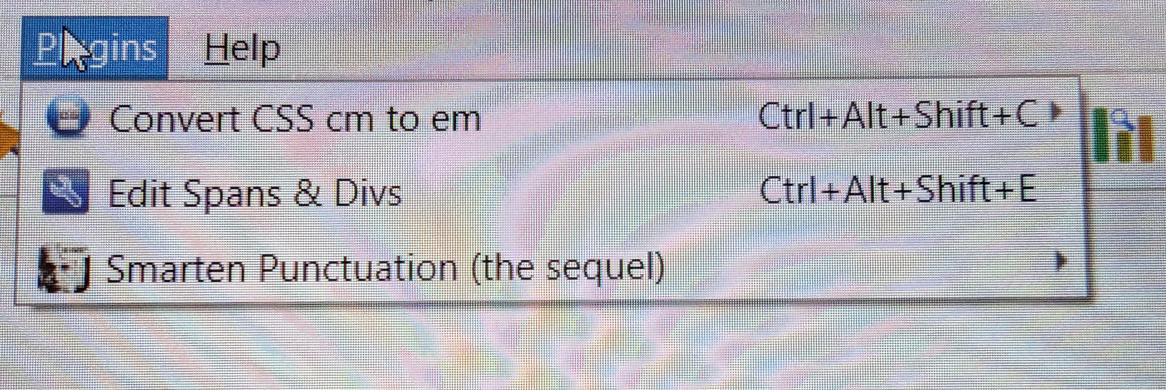

There are arrows for convert CSS cm to em and for smarten punctuation, each leading to check for edit current file only. There is no such arrow for edit spans and divs, at least not on version 0.4.0 which is the version Calibre lists and is in the OP of the plugin's thread.

In the editor, go to Edit>Preferences>Toolbars
Select "Book wide tools from third party plugins"
Move the Edit Spans Divs icon from the left panel to the right panel
Press ok
You need to make the change from the icon, not the menu.
Press ok
Edit Spans Divs was already in the right panel, along with the other two. Nothing to change.
You need the icon for Diaps Edition Toolbag to be in the toolbar so you can access the arrow on the right of the icon that you need to click. If it's not in the toolbar, you cannot change the settings. You cannot change the settings from the plugins menu.
I know @Karellen already posted this, but you seem to have either missed it or ignored it so I'll post again.
In the editor...
  1. Go to Edit > Preferences >Toolbars
  2. Select "Book wide tools from third party plugins"
  3. Move the "Edit Spans Divs" icon from the left panel to the right panel
  4. Press OK
