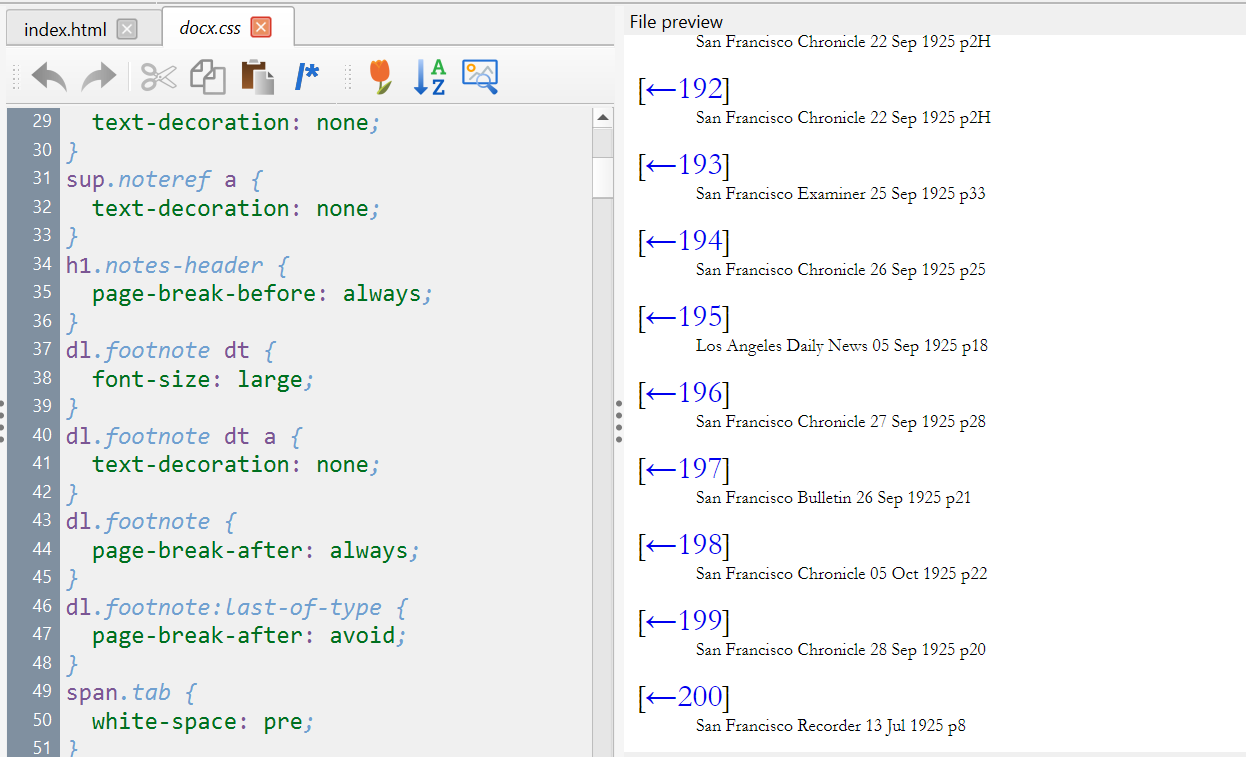

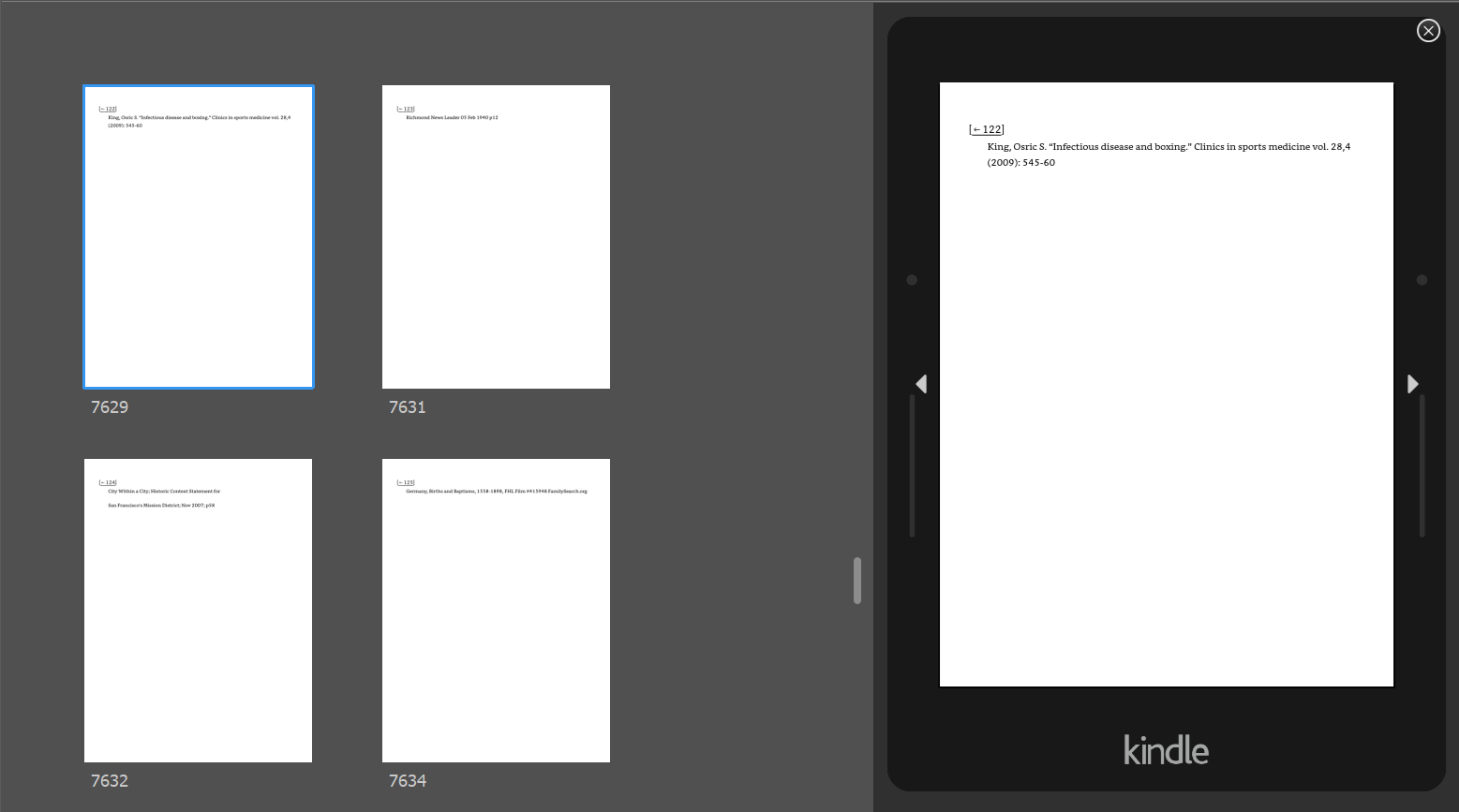

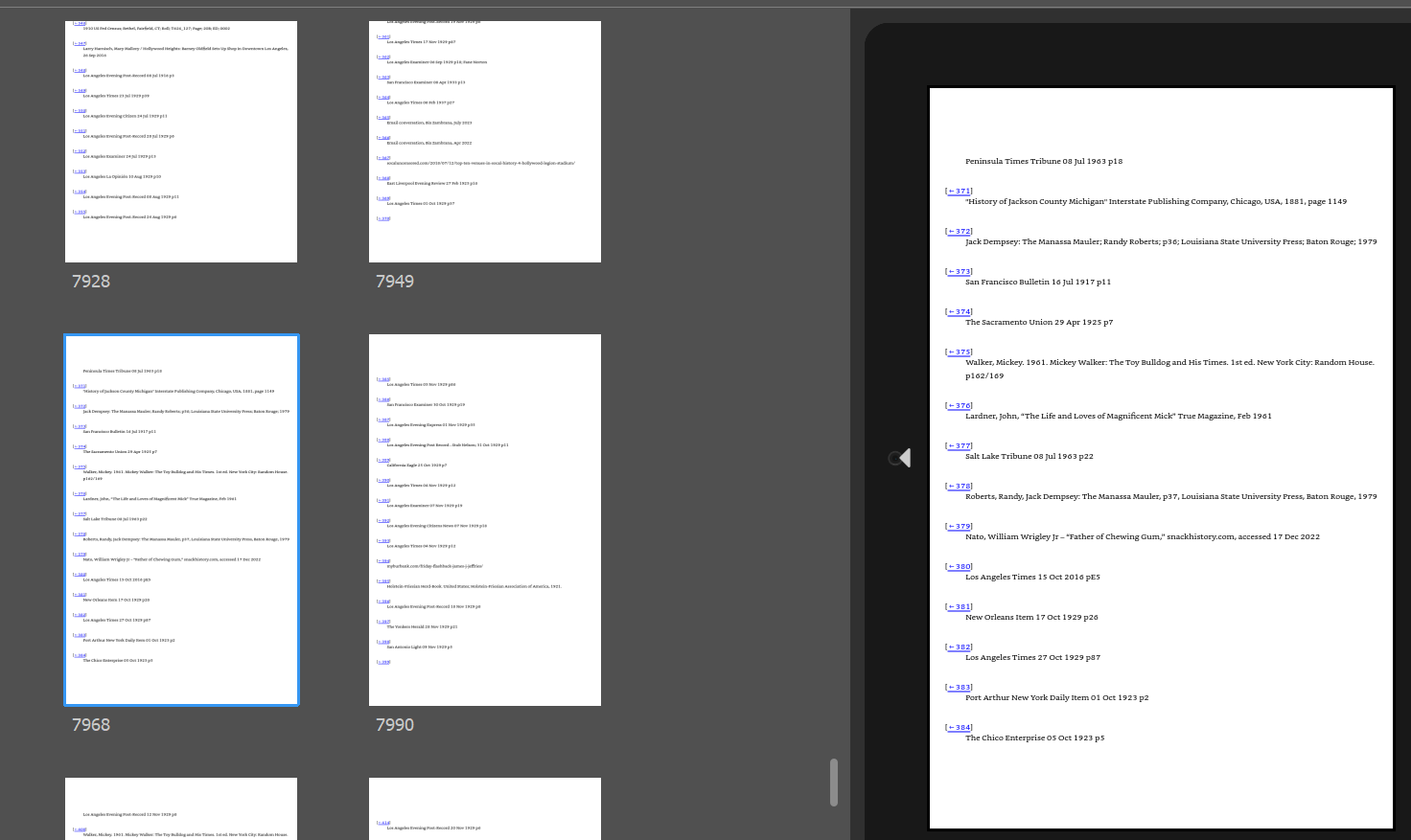

Hi Folks,
I dropped my Word2021 docx with multiple endnotes (insert>endnote in Word) into Calibre (latest ver), converted to epub. I then dropped it into Kindle Previewer and all endnotes are on separate pages. (see 3 images attached),
Two questions:
1) What should I examine, and in which SW, to determine a fix? I'm comfortable with finding and fixing, and adding, small things in css. I'm better in html. Pretty tech savvy just need general steps.
2) Viewing my endnotes in Calibre, why are the numbers huge, and where can I fix please ? I suppose it doesn't matter too much, since Kindle Previewer, displays them correctly, just curious.
Have spent a number of hours googling an answer, and am at the end of my rope here, so hoping for a resolution.
Thanks much!
Cat

Yes in the css file I've changed "font size: large" to smaller, in the css file, with no appreciable difference.

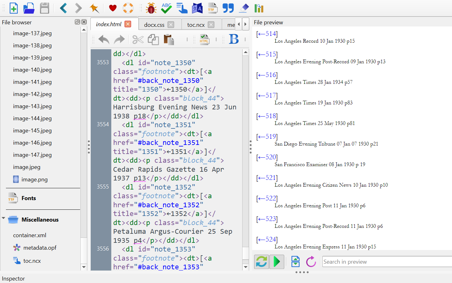

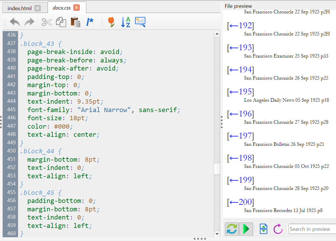

We'd need to see the code for "block_44" and the code for <dl>, <dt> and <dd> in the css. Maybe one of those contains a forced page break.
Old 08-11-2024, 06:25 PM   #7
frankiesgal
frankiesgal began at the beginning.
Posts: 8
Join Date: Aug 2024
Here you go, thanks. Just tried various supplied default endnote/footnote styles in word, to no avail.

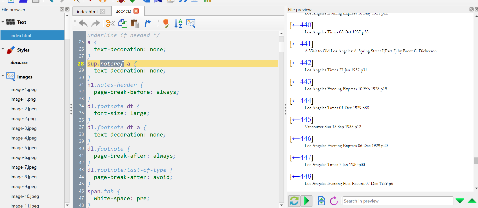

There is the problem. First image...
dl.footnote {
page-break-after: always;
It is forcing a pagebreak. Delete that tag and see if it fixes the problem.
And contributing to that problem is that each footnote/endnote uses its own <dl> tag set. Whereas it would be better to use one <dl> tag for all the endnotes.
Old 08-11-2024, 07:23 PM   #9
frankiesgal
Posts: 8
Join Date: Aug 2024
You are marvelous!! Here's where I'm at right now. I changed the dl font size from large to x-small, and replaced the footnote page break from always to avoid. Is that okay?
I'd like the endnote text to be on the same line as the clickable endnote number, for a cleaner view and to reduce pages vs what the attached shows. How might I do that?
Just grinning right now, thank you !!!!!!
Removing the use of the <dl> tag set which is designed for terms and definitions to be on separate lines. See...
https://developer.mozilla.org/en-US/...TML/Element/dl
Maybe try this and see how it works...
<p><span id="note_1350" class="footnote"><a href="#back_note_1350" title="1350">1350</a></span> <span class="block_44">Harrisburg Evening News 23 Jun 1938 p18</span></p>
