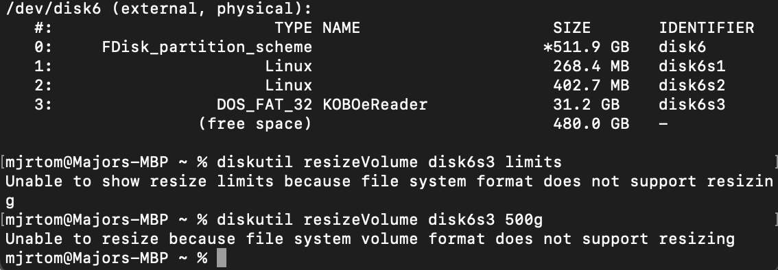

Hello, is this Mod dead?
I have 2 NIB Kobo Libra 2s that I am attempting to upgrade for my nieces.
I am running OSX 14.6.
I ran into the sbin issue and got around that.
I put the renamed KoboRoot.tgz file into the .kobo directory.
The device 'updates' and reboots when unmounted, except that it reboots fully into the UI
Plowing on ahead with removing the sd card and inserting the blank one, the process with the loading bar appears to start as soon as I interact with the UI, but not before, and then it hangs every time.
I have been able to use terminal commands as other users to clone the card directly but am unable to resize the FAT32 partition. The Kobo device does not boot from the cloned card.
Disk Utility does not have the permissions to write to the SD card from a .dmg, only terminal
Major_Tom is offline   Reply With Quote

Since you have the original working µSD cards, I would recommend using whatever utility you prefer for creating an image of the card ( BalenaEtcher seems to be popular ) and then copying that image to the new larger µSd card. DiskUtility should be able to resize the FAT32 partition once the copy operation is complete. Repeat for the second Libra 2.
Not sure about your issue with Disk Utility though you are mentioning dmg which sounds as if you are trying to modify the disk image not the physical disk. There are other MacOS partition managers but I haven't made use of one in several years.

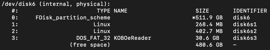

When I mention the .dmg, I am referring to the 'restore from image' function of disk utility.
Balena worked a treat, and was already installed, I just didn't think of it. I am now able to boot from the cloned drive, but am unable to resize the partition with either disk utility or terminal, the former of which doesn't give me the option, and the latter of which tells me the file system doesn't support it
