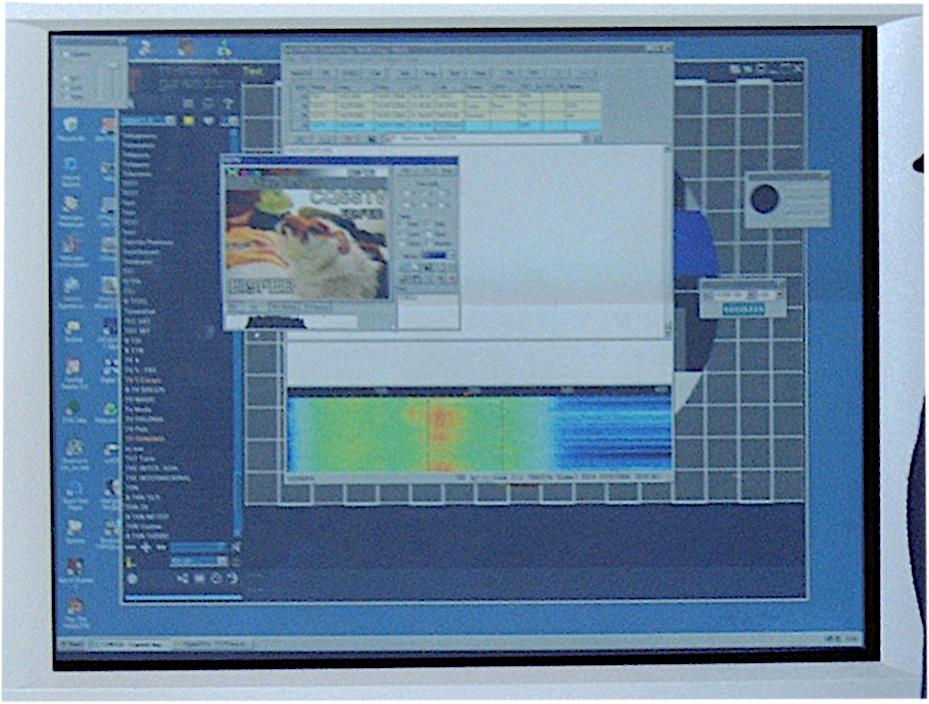

I think the only future for eink is price labels and mono eink readers. More cheaper mono readers in 5", 9" and 12" as well as 6" to 10" are needed. Too few sizes and too expensive. I had a paper-like CRT 20 years ago. Finally tablet & phone makers are producing true zero glare/shine panels that have been possible for decades.
A no glare/zero shine paper-like CRT I had in 2004 and it wasn't new then. Scanned flim.

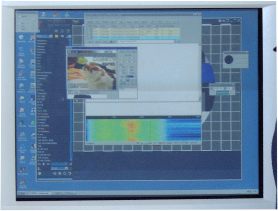

Raw version
Only cropped from original photo.
Mitsubishi
