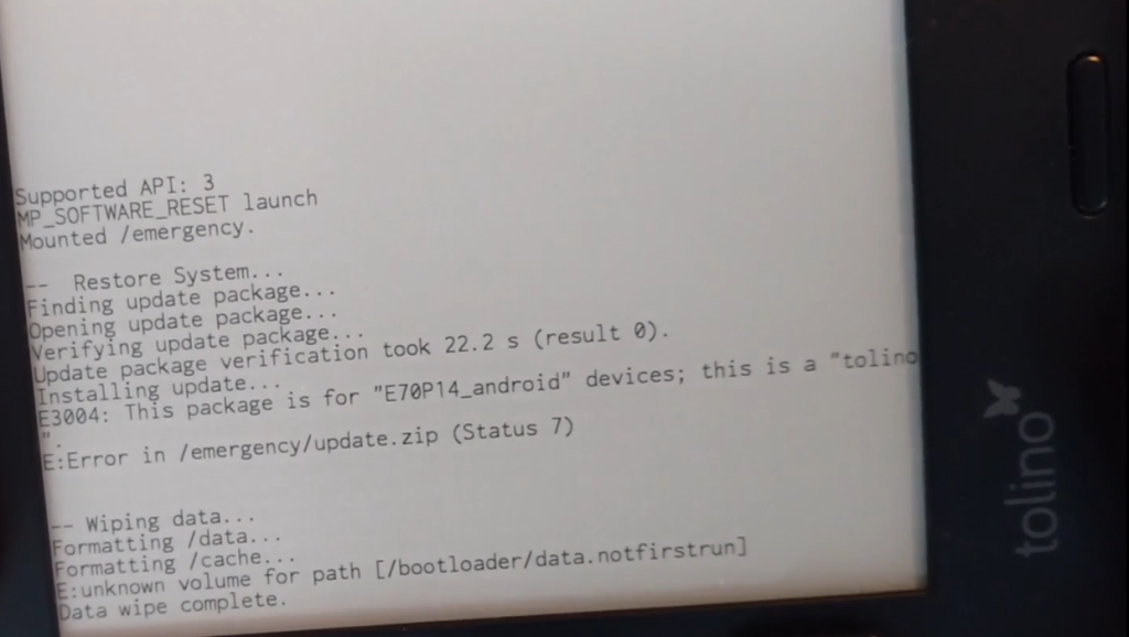

Reverted back to stock recovery, but can't boot there.
Could someone send my an SD-Card image for 37NB-E70P1M+6B2 ?
Thanks !)
Yuriy is offline   Reply With Quote

It worked, thanks !)
The only issue - serial number.
I've also tried images for Kobo N418 Libra 2 vE - no success, even no led.
