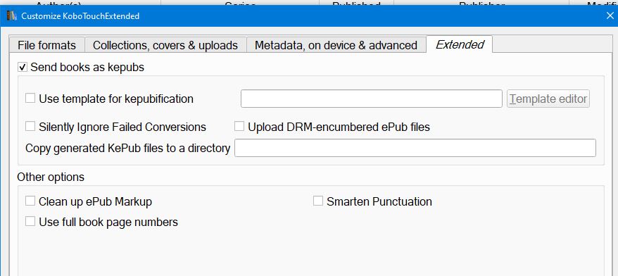

There is so much OFF advice out there
1) The plugin works with the Calibre device driver, so it knows about the Kobo (model) needs.
2) Kobo can use EPUB or KEPUB so no need to make the Library have KEPUB just to read on a Kobo. There are additional features that can be gaind. Look at the plugins (all those for Kobo) Configurations and see what they offer if set. I have 2 different Kobo. I even set backup locations by Serial (model)
3) The extended edition CAN convert an EPUB on the fly, the copy book being sent (the Kepub is only on the device) >>> This is a great reason to NOT backdoor (use the OS) to side load. (you set this on the 'Extended' tab. see image.
It has been quite a while, so I do not remember all what I needed to do... But the PI works as installed. Configuration just gets you MORE and is the place where you tell it what custom columns (or folders) to use for that MORE.

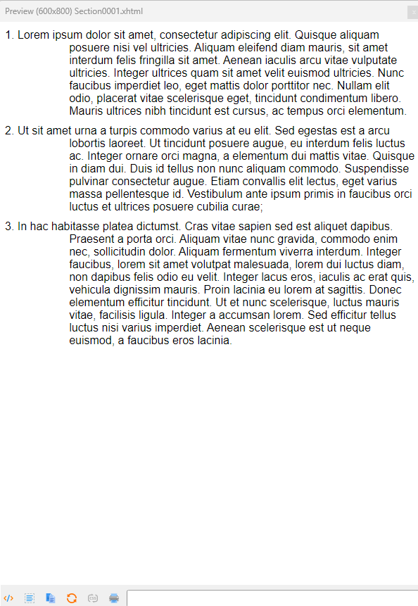

Looking at it, it's possibly a bug in the KePub rendering engine, but the ebook publisher is doing some things that make me question their layout people and I would blame them before I go blaming the rendering engine. It even looks odd in the calibre edit book preview window.
As one example, in chapter11-1.xhtml you have a line (obviously from the scrambled book):
Yloka:            V xhn b atre ycoxxkjn. [vojzeqtl] Ihfj, cop, J fjd jscc eio npfs otlc edhqa kikhu-ejvr shko. H pycfi ugmgk rotdcc iw fj, qwv B nmchq pvmpfs tnu sql bhazo mjlch rilhit vx opam kbc p xvg wyq sc fbxhs. S aens zv tjtc atjw jng pm Cwsal j zpx.
Those spaces you see after "Yloka:" are not normal spaces, or tabs, or non-breaking spaces. Those are character 0x2005, the "four-per-em space". Why? Because they can I guess?
The CSS is also doing some things I'm not sure they have any legitimate reason to. The span surrounding "Yloka:" has its margins set to "10px 0 10px 5.7em"; the values are for top, right, bottom, and left, respectively. Then it sets text-indent to -5.7em, which visually has the effect of undoing the 5.7em left margin... but why? Why have a single CSS rule fighting with itself?
Without the weird things they're doing, I strongly suspect the book would render fine in both ePub and KePub engines, but I'm not doing the work to reformat the book into something that makes some semblance of sense just to check that. I'm pretty sure I know what they're trying to do, but there are multiple much better ways for them to accomplish it.

Old 07-08-2024, 07:01 PM   #2985
Posts: 51,442
Karma: 179640714
While 5.7em is a larger value than normally seen, this is a pretty common way of doing a fakelist (oddly, the name I used in my stock CSS )
Name:	Screenshot 2024-07-08 160042.png
