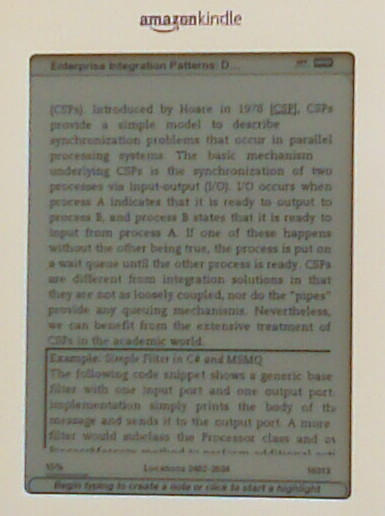

Here are some screen shots of the problem. Sorry for the fuzzyness. I used a low resolution phone cam ...
Here is the text when I mark it with the thumbstick ...

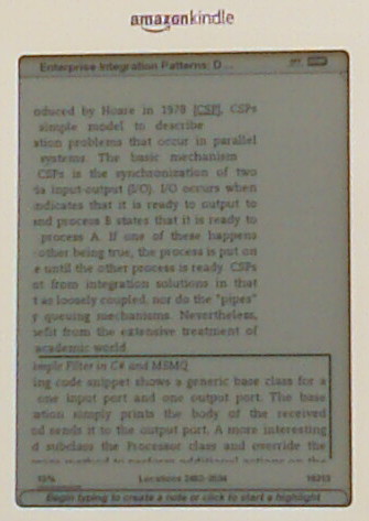

and here is the text after I have scrolled to the right ...

I thought it might be related to tables. The frustrating part of it is that, at least in the case I have shown, there is no need for table formatting; it's just a single paragraph of text.

If you can scroll to the right then the problem is definitely caused by a table. I'd ask for a refund. That book has a major deficiency. Also, complain to the publisher.
