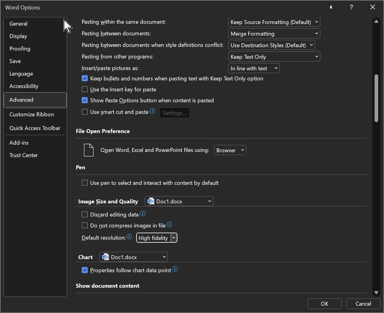

I make it a practice to resize, resample, compress image files destined for embedding before I insert them in the DOCX, EPUB, PDF… whatever. If that means having different versions of the same images then so be it; my asset management practices take care of that.
Check this setting in calibre:
Name:	2024-06-21 09_12_42-calibre Welcome wizard.jpg
If it is set as shown, calibre leaves images alone, and Word will do the same if you have its Advanced Options set like this:
Name:	2024-06-21 09_39_51-Word Options.jpg
