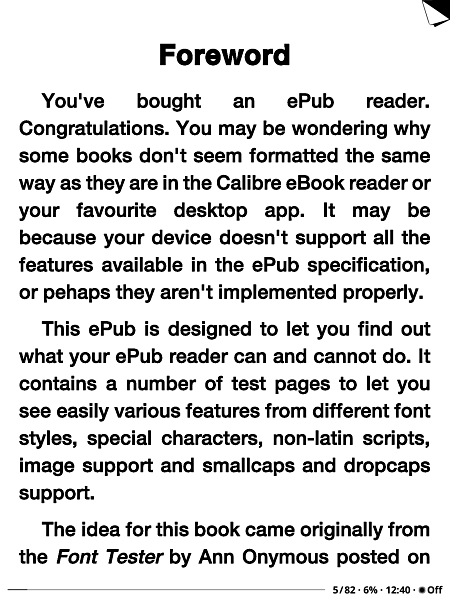

I'm resurrecting this old thread because I would like that too.
The dogear icon in Koreader is so small, I'd like it a bit bigger.
For comparison, I attach 2 images: 1 is Koreader, 2 the default Kobo interface
1
2
I tried looking at the page linked above, but it seems that the focus shifts to other issues at some point and the thread gets closed because the OP is happy with an alternative solution.
I still don't know how you can enlarge the icon that to me it seems too tiny (if it's even possible to).
Thanks

Ok, so beautiful Kobo bookmark in KOReader (in correct size): check.
On unrelated note - is there any custom patch that can tell the reader to NOT touch already bold fonts when increasing font weight? Default behaviour looks just simply awful...

The margin limitation still kicks in and limits the size of the dog ear, in other words, patch does not work unless you change the margins, which I personally don't want to do.
that black in the background of the page makes it look better, I wish KOReader could introduce that too, the shadow too but that I am not too bothered about.

the solution in post #9 worked for me and made the dogear icon bigger on Koreader (I multiplied by 3 too).
I tried also what hius07 was suggesting in their post, but the result was that the icon overlapped some letters of the text in the upper right corner.
I would like to be able to have the "beautiful Kobo bookmark in KOReader", as greentea says in their post (that is, the icon in my photo #2 and the photo attached to their post), that would be the best outcome for me. Any ideas how that could be possible?
If not, I'm already satisfied with having now a bigger icon than before. (I understand I will have to fix it again with a new update)
Thanks!
