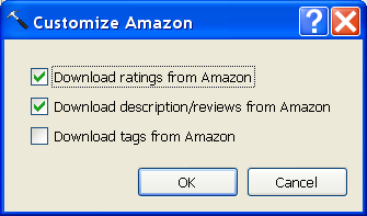

My solution was to not download the tags to begin with. The metadata download plugins allow you to turn off downloading tags and allow everything else.
