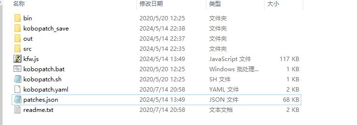

And the firmware should be put into src folder.

Yes, just make sure that you have downloaded the correct firmware for your Kobo

Thanks again. It works.
