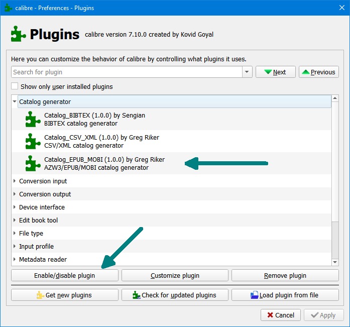

Hello,
For some reason, when I try to create a catalog I'm only given three format options: BIB, CSV, XML. Epub format is nowhere to be found.
See here: https://i.imgur.com/yUe6goU.png
Does anyone know why this is happening? I remember being able to do epub catalogs before. I have v.7.10 installed.

At some point you disabled the epub/mobi catalog generator plugin.
Preferences / Plugins:

Thank you so much, chaley. That was it!
Grand Sorcerer indeed.
