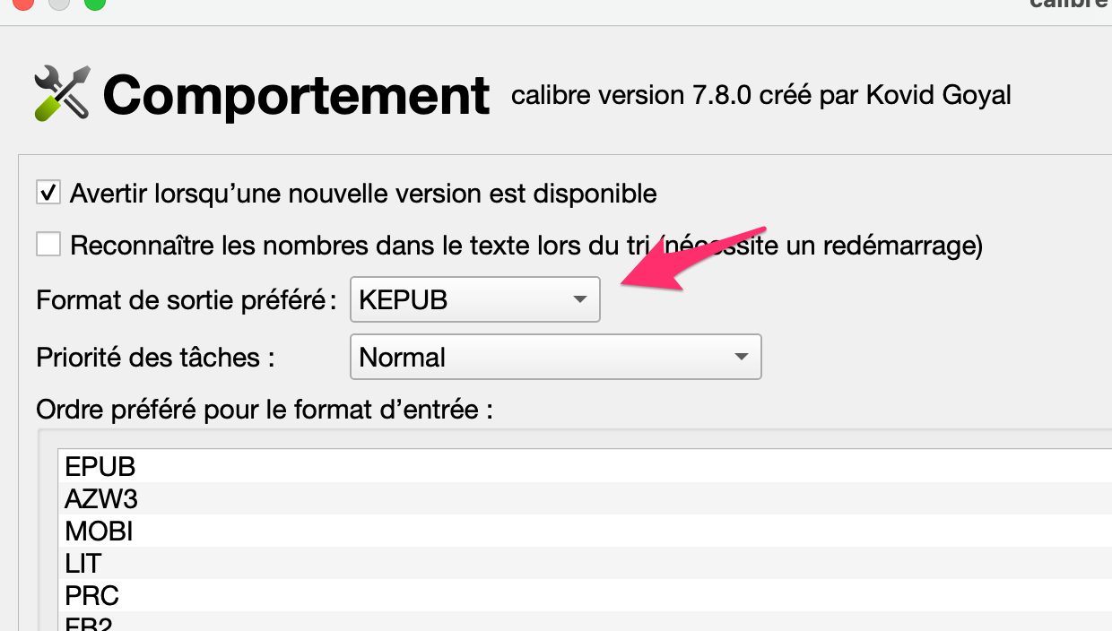

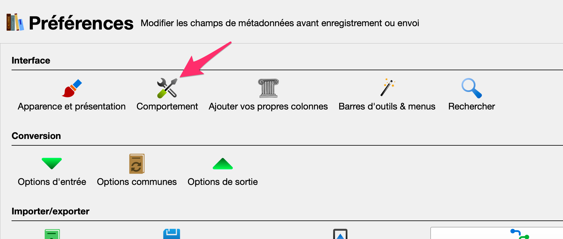

You also have to set something up in Calibre Preferences. (Sorry, in French, but you get the idea, I hope.)
Attachment 207679
Attachment 207683
No, that's not necessary. I've never had KEPUB there.
EDIT : Again, no good information is provided by this post. Sorry...
From the plugin official page here :
https://www.mobileread.com/forums/sh...d.php?t=220565
Usage
To use this plugin after installing:
Select the book(s) you want to convert.
Select the KEPUB output format
Choose your settings
