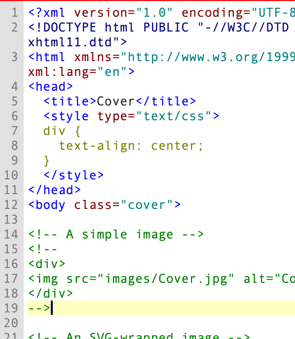

Okay, after some more experimenting, I now have a way to double the insertion point text cursor width from the default 1 pixel wide to 2 pixels wide which helps to make it easier to detect. This should work in all FindReplace and all QLineEdits too.
Remember the insertion point cursor has to fit between adjacent characters. So the wider it gets the worse it looks when fonts with kerning and tight letter spacing are employed. So going more than 2 pixels is not recommended.
It is reasonably painless and seems to work requiring only a few small changes in CodeViewEditor.cpp and main.cpp.
So I am thinking of creating a Sigil Main UI Preference Appearance to enable or disable it. Changing this setting would require a Sigil restart since it involves changing the main application style on the fly.
So something along the lines of:
    [] Make text cursor insertion point more visible
I would like to know if our users would find this useful or not before fighting with the Sigil Preferences again (or begging DiapDealer to do it!).
I have attached two screen shots. Since they are static, no blinking involved. But look at the end of the xhtml comment at the line in yellow to compare the text cursors before and after.
Note: these screencaps appear much larger on the screen when I open them here on Mobileread than the actual on my display so both appear reasonably easy to see but that is not quite how it seems to me. Not sure how to show the difference otherwise.
Happy to contribute.
But I worry that vertical space on the Main UI tab of the Appearances Prefs might be getting tight for space. It would mostly affect laptop users with smaller screens, but still....
There's probably a couple of options to get around it. One would be to create a new Accessibility tab that I could put the new Show Widget Focus pref and this proposed larger insertion point cursor on. Another option would be to remove the Tweak Drag Distance preference. I consider it to be a veritable boat-anchor at this point anyway. I could drop it completely, or if someone can convince me it's being used (Qt5), I could replace it with an environment variable setting for the two people in the world who might find it useful.

Cursor insertion point more visible: I wold vote Yes (as would most of my age group, I'm sure.)
I did this in Writer quite a while ago, and it makes a huge difference, even when using big text on a huge screen. (The Writer solution is a gtk.css file trick, so it probably wouldn't wouldn't help in the Qt world, I got it from here: https://askubuntu.com/questions/1027...ter-appearance)
