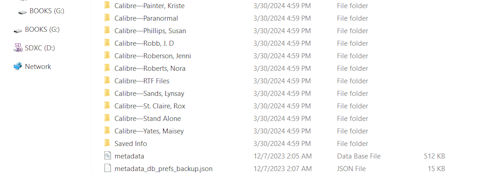

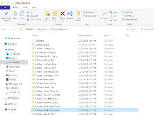

I had to reinstall my Windows 10 Pro OS and I kept all of my old data. However, when I reinstalled Calibre it won't import all of my old libraries, and I have a lot of them. I have all of the books in the main Calibre LIbrary but then I have all of the individual authors in their own library so I can easily switch working with one author to another:
How can I make Calibre recognize all of my libraries?

Were your author libraries physical libraries or were they virtual libraries (essentially a library created from a search), in this case author name?

OK, I'll try that. And all of the author libraries were actual libraries. But I don't see anything about paperclips on here! I did manage to upload them using the Attach Files under Additional Options but I don't know if they will show up with this post.

You appear to have all your libraries (Calibre Library, Calibre--Arken G.A. etc) inside the calibre library "Calibre Libraries" - because it has a .calnotes folder, as well as a metadata.db file that folder is a Calibre library.
I would suggest you ditch the Author and Genre libraries (Anthologies, Fanfiction etc) and use calibre as its meant to be used - via it's database, which will be infinitely faster than switching between dozens of libraries.
