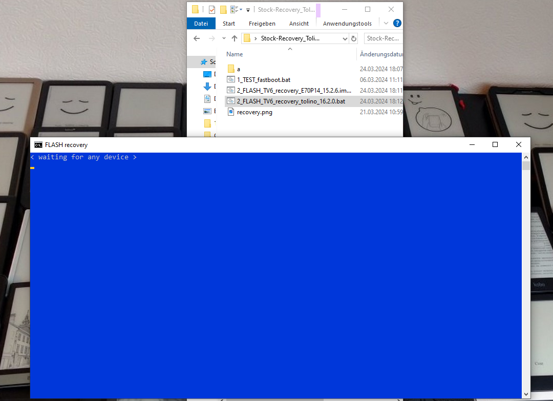

upd... First, remove the original µSD card and clone it onto a new card, preferably a larger one. We perform all the steps described below with a cloned card. ...upd
Here's one option:
You may need to install the driver in Device Manager first.
Find out what firmware to restore on the device.
Flash the appropriate STOCK-RECOVERY and do a reset.
https://mega.nz/file/uxdDUBbY#toGh1A...vIYsxWIy2qe8xk
https://mega.nz/file/vlkhxKhC#kG5omF...AqU6xWRAMJHRU4

upd... We perform all the steps described below with a cloned card. ...upd
Then install TV6_recovery_tolino_16.2.0.img.
If during recovery it gives an error like in the video, then you need TV6_recovery_E70P14_15.2.6.img.
Now only tomorrow I will write what needs to be done in this case.
https://mega.nz/file/uoN0TIQZ#oBn7cU...48vqTOtbgUc1tY
And just in case, I’ll write, do not install TWRP before updating the firmware. The Stock-Recovery must be installed.
And you also cannot boot the device into recovery mode using hardware buttons?
You can flash it in another way.
https://mega.nz/file/fwchAQKR#AZ6mAx...mHBZ_P6U8na5Ow
We connect Tolino to the PC.
Turn off Tolino by holding the power-button for 10 - 15 seconds.
Click 2_FLASH_TV6_recovery_tolino_16.2.0.bat.
Now use the buttons (bottom page turn button + power-button) to boot into fastboot until the command is executed.
Next, disconnect the Tolino from the PC and, using a long press on the bottom page turn button + power-button reboot from the mode
fastboot to recovery mode.

I'm currently able to flash it via 2_FLASH_TV6_recovery_tolino_16.2.0.bat, able to boot into recovery mode now. Thanks for this help! Will retry your prior suggestions
