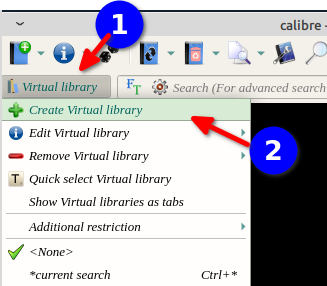

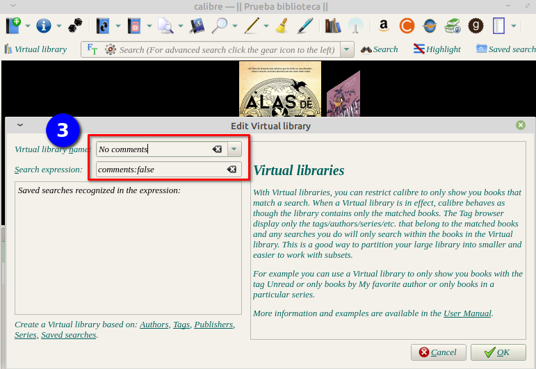

@awakil. After entering what @theducks told you, you can save the search in a virtual library to always have it at hand

Old 03-24-2024, 05:09 PM   #9
