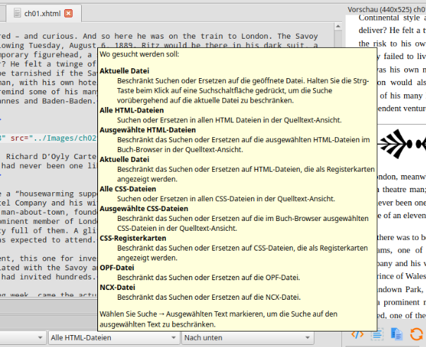

Let me then change my request. Could you please increase the number of clip icons, and also adjust the toolbar to use the full width of the window?
I've attached a couple of screenshots to better explain what I mean. As you can see, the clip icons only take up around half of the toolbar.
The second screenshot shows the popup when I mouseover the 'Alle HTML Dateien' selector.
Rgds
Karl

I am confused ... What platform are you using?
You control the width of the toolbars. If a toolbar is too long, shrink it and place another beside it on the same line. If you have all 20 clips icons in a line, it should fill up the toolbar.
And where is that tooltip coming from? It looks like the description of the Find and Replace targets. Is that the one? Is this in the Find and Replace Dialog or is it Saved Searches Dialog?
And if you do not want the tooltip, why bother hovering over it? Most tooltips are quite short. That one must be the worst case.
Turning off tooltips is probably not a good thing for general users. But we could hide that one under a pop-up ""Help" menu of some sort.

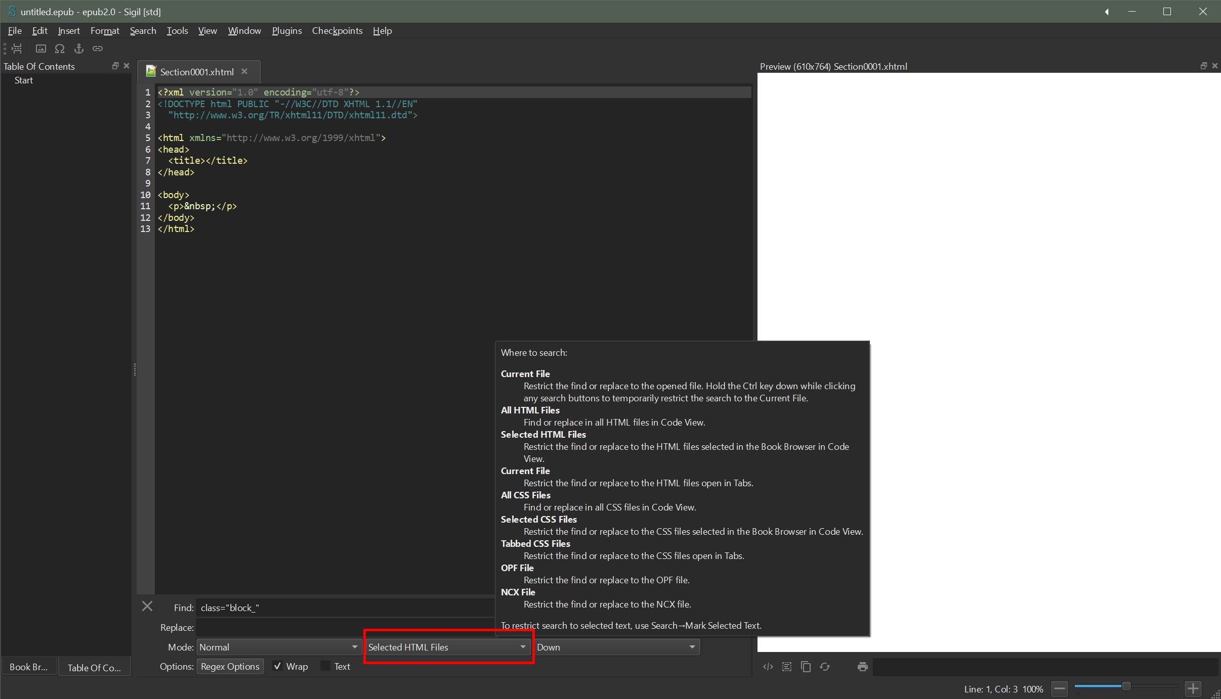

Old 03-23-2024, 05:40 PM   #5
Posts: 22,034
Karma: 30277960
It's from here:
Name:	Screenshot 2024-03-24 072642.jpg
On Windows, Sigil's tooltips persist until the pointer is moved, in most applications (including other Qt applications) they disappear after a few seconds - sometimes too few.

It's from here:
Attachment 207103
Thanks. It is in Find and Replace then. I had no idea tooltips would stay so long on Windows. I will take a shot at shrinking that tooltip down to something like: "select the target files for the search" in a future release.
