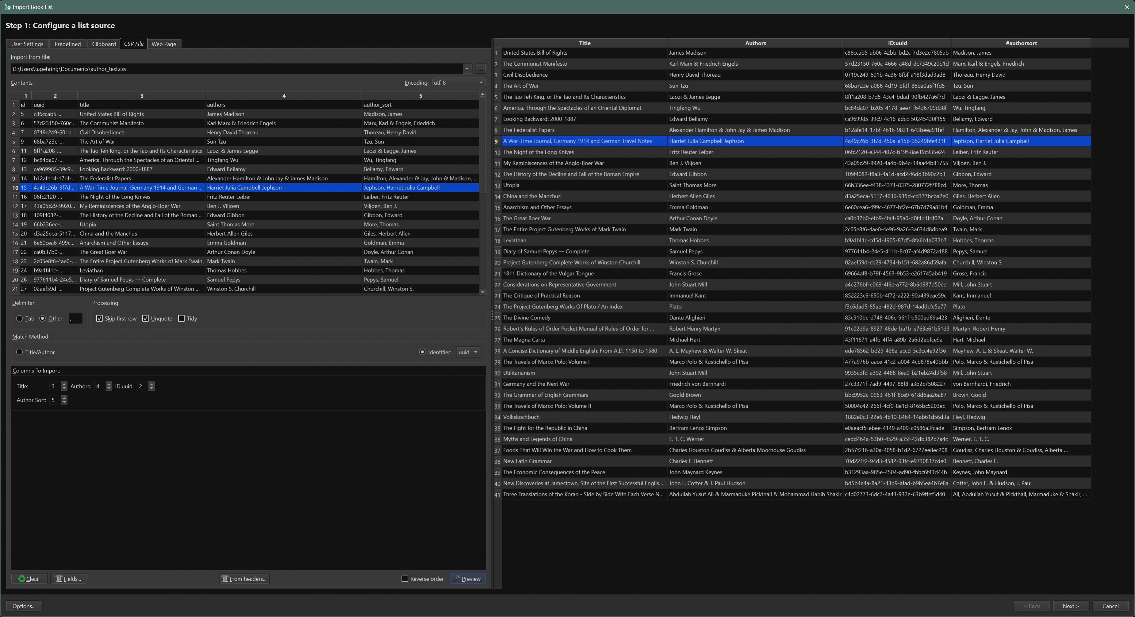

Originally Posted by tagehring View Post
I have a CSV file with columns for UUID, title, author, and author_sort for each of the books in my library that I've manually corrected in Excel from catalog output. I've tried using Import List to import the corrections via CSV file but have run into a few problems.
  1. There doesn't seem to be a way to correct the author_sort value this way at all.
  2. If the author field has significantly changed, Import List returns an error even if the title is identical. When I use the plugin to match the CSV row to the book, it doesn't overwrite the correct author information from the CSV file.
  3. To solve #2 another way, despite manually matching the "ID" column of my CSV file to the ID:uuid identifier, I cannot get it to index using uuid. Every row returns an error. (See attached.)
I am at my wit's end trying to get this to work. Any help is appreciated.

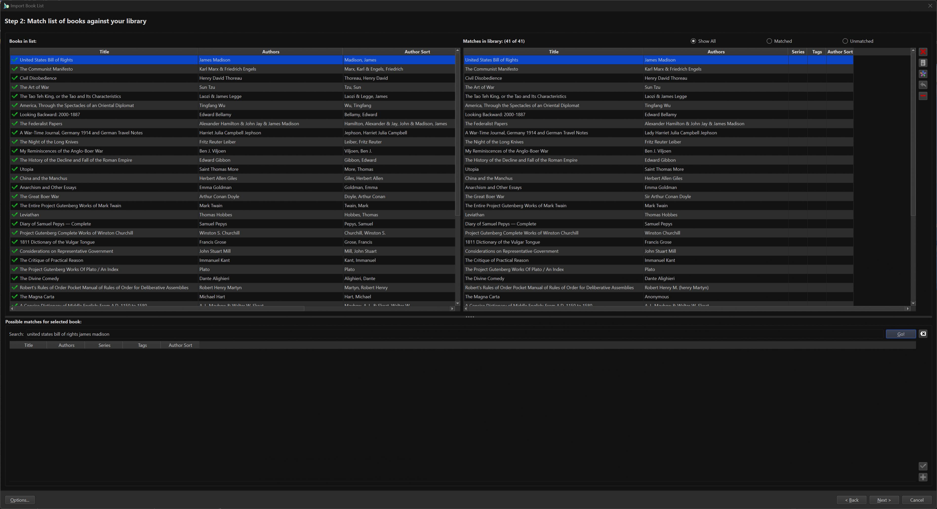

Adding screenshots of the problem after fixing #2 above. I'm trying to map the author_sort to a user-created Author Sort column, I know it's not the default author_sort metadata tag. But I would prefer overwriting the default author_sort via CSV if possible.
Name:	2024.02.22-081935-Import Book List.jpg
ID:	206525   Click image for larger version
Name:	2024.02.22-081947-Import Book List.jpg
ID:	206526   Click image for larger version
Name:	2024.02.22-082032-calibre — __ Calibre Library __.jpg
I suspect that it isn't possible without changing the plugin. The problem: depending on the API used, changing the author causes calibre to recompute the author sort. If the plugin sets author after author_sort then the recomputation will overwrite what was set. If my guess is correct then the fix would be for the plugin to ensure that author_sort is always set after author.
The most reliable way to do this is an expansion of what you are already doing.
  1. Clear all values from the sort custom column using bulk metadata edit.
  2. Run Import list.
  3. Select all books now having values in the custom column using #column_key:true
  4. Use bulk metadata edit / search and replace to copy the custom column to the author_sort column.
You could use the Action Chains plugin to do all the above steps in one chain.

Just as a friendly note to kiwidude, there was a crucial step I was missing and didn't find it anywhere in the documentation.
There's no mention of the "Update Metadata" button in Step 2. As I discovered, unless you select all of the books you want to commit changes to and then click this button and select which fields you want updated, nothing happens. From the UI it wasn't immediately obvious what it did or that it was necessary until I hovered over it with my mouse and saw the rollover text.
It might help future users having the same problem to add this scenario (call it Replacing Existing Metadata, maybe) as a usage example on the wiki.
