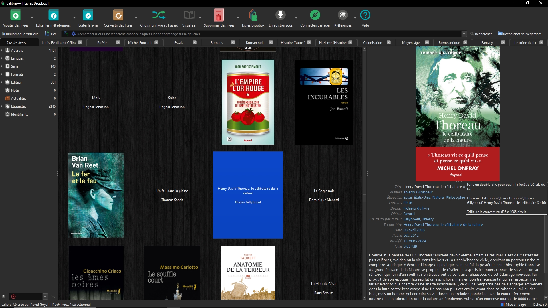

Strange behavior, i noticed that when i bulk edit the metadatas of all my books (in library 1), to repair the missing covers, it does the trick but it affects library 2, making covers disappear... Library 1 is on the HDD and Library 2 (duplicate) is sync via Dropbox sync tool.
And therein lies your problem, see ==>> I am getting errors with my calibre library on a networked drive/NAS?
If you are using a file-syncing tool it is essential that you make sure that both calibre and the file syncing tool do not try to access the calibre library at the same time.
Sort of. I will close Calibre before syncing. My point is that i think both libraries are in some way, related
Calibre uses caching to improve performance, it's conceivable that some parts of calibre (e.g. Book details) are picking up cached covers for some books in the library you have in your Dropbox account and other parts of calibre (e.g. the grid) aren't.
