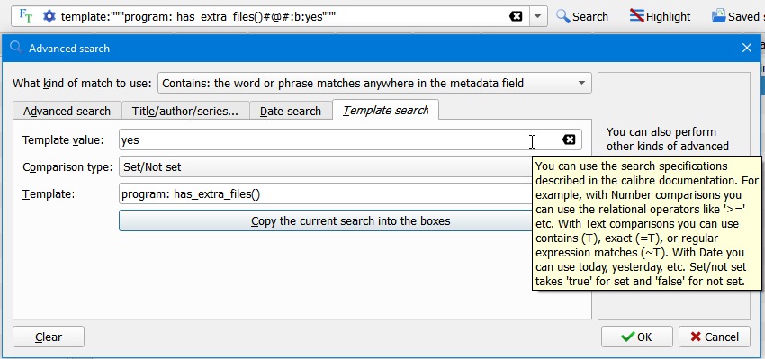

In most cases template searches are built using the Advanced Search dialog, as the documentation suggests. That is what I do. The tooltips in that dialog explain much of what you can do.
You can use the "Copy the current search into the boxes" in that dialog to see what a search you found elsewhere, e.g., in a forum post, is doing. For example, here is what you see with for your 2nd template search.
As for why it is faster, the 2nd template has a smaller, simpler program: it doesn't use an if/then/else. For smaller libraries or fewer data files, the time to execute the 'if' statement is a larger percentage of the total.
