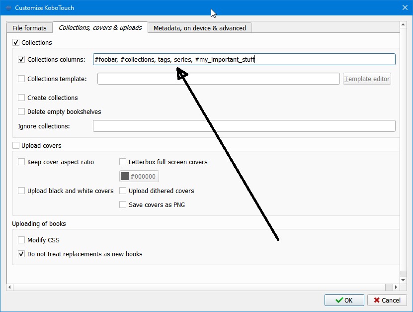

I suspect that we are having more terminology problems. "name" for me is the column heading. "lookup name" is the lookup name. The two are very different.
Put the lookup name of the column that contains your collections into the driver. Like this:

As I said before, I think you want to put #myshelves into the Kobo collections box. Do that. If it doesn't work then post
  • An image of the Kobo dialog showing the collections box.
  • An image of the #myshelves column definition dialog.
  • An image of the Edit Metadata dialog showing the contents of #myshelves for some book.
  • An image of the "Sending books to device" preferences dialog showing what "Metadata management" is set to.
  • A copy of the calibre debug log showing the Kobo connection. To get the debug log:
    1. Start calibre.
    2. Click on the down arrow next to the Preferences button
    3. Choose "Restart in debug mode".
    4. Wait for calibre to restart.
    5. Connect your Kobo.
    6. Wait for the connection process to finish.
    7. Disconnect your Kobo.
    8. Close calibre.
    9. Post the entire log that appears in a dialog.
Originally Posted by Chocky View Post
And I don't even know if when I have sorted Calibre out it will update the Kobo with the collections, or whether it only does this on loading the book to the Kobo
If you followed the directions and set Metadata Management to "Automatic" then the collections are updated every time the Kobo is connected to calibre.
