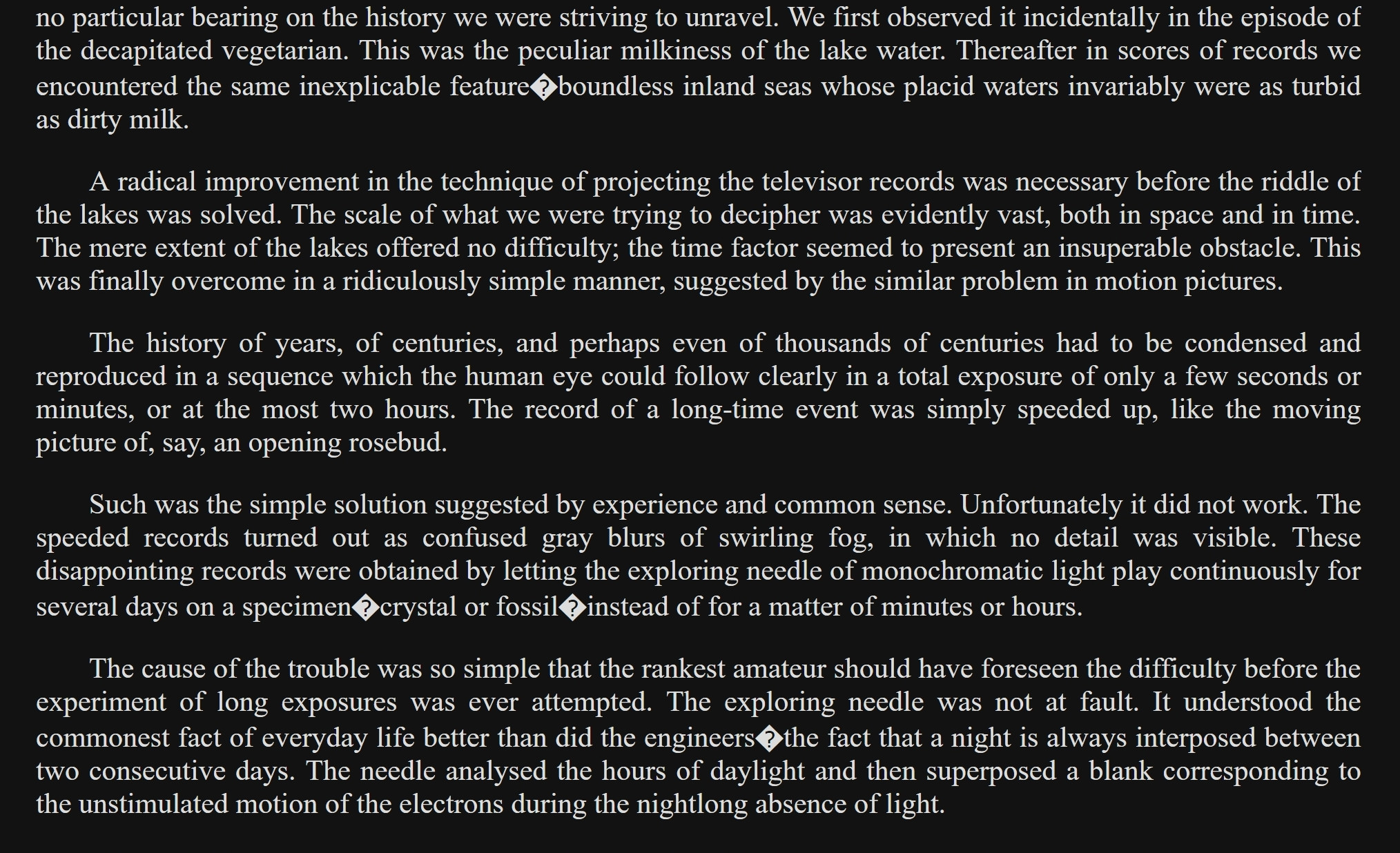

I created an ebook (epub) from a Project Gutenberg book that was in html format after importing it into calibre but the result has rhombus question marks. Otherwise it came out pretty good. How do I remove these rhombus marks from the newly created epub? If I have to redo it that's okay but I just want an epub free of these marks.
https://i.imgur.com/EafI07i.jpg

I think they may be unknown glyphs in the font you are using to read the epub. You could try embedding a font within your epub that contains the glyph. Chareink6 might do the job amongst others, and it’s available on MR.
https://www.mobileread.com/forums/sh...ight=Chareink6
Or maybe your .opf file in the epub is not encoding to utf8?
"Modify epub" in Calibre will let you do this painlessly.
The first line in mine is: <?xml version="1.0" encoding="utf-8"?>

I concur. Those are missing Glyph symbols.
Either your current font does not have those
or
the book used the wrong character set during conversion (from text) somewhere along the line.

Update: I did discover a fix. Instead of just saving the html directly from Firefox's Save Page As, I used an FF extension I've been using for years called SingleFile (which saves the complete page). Once I imported that html/zip file into Calibre then converted it to epub, it created a perfect epub ebook of the entire novel with no strange rhombas marks. Now if only I could figure out how to create OCR html files from those PDF ebooks I got off internet archive to convert into epubs...

Probably the file is encoded in Windows-1252, but the declaration says it is UTF-8.

What is the character that's not displaying? Is it supposed to be an em-dash or en-dash? If it is such a charcter, it's quite easy to load it into the calibre editor and perform a search/replace to fix this.
