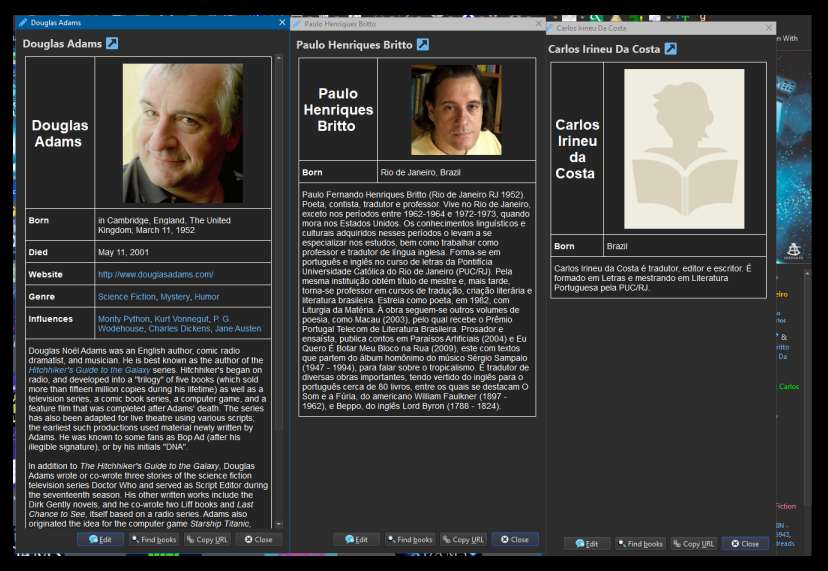

With the notes feature in Calibre 7, I thought of a new plugin that I knew I would want, so I wrote it and am sharing it here.
This plugin pulls author information from GoodReads and writes it to the author note.
Everything is organized in a table (see example below) and the background color, border color, and text color can be changed in the plugin configuration. It defaults to the colors shown in the example image.
Currently, it uses a Goodreads function that is also used by Calibre to "guess/search" the author page. This is almost always correct, but if you have an author where a more well-known author has the same name as the author of your book. For example, if you have books by South African novelist Peter Abrahams, Goodreads will return American mystery writer Peter Abrahams instead.
If the author isn't found or if the author exists in Goodreads, but has no biography information, they will be skipped.
Please let me know if you find this useful or have any suggestions.

Wheee! Amazing plugin. Just tested it on a book with multiple authors (actually the author plus two translators, from the time when I didn't have a dedicated translator column), and it processed all three smoothly:
