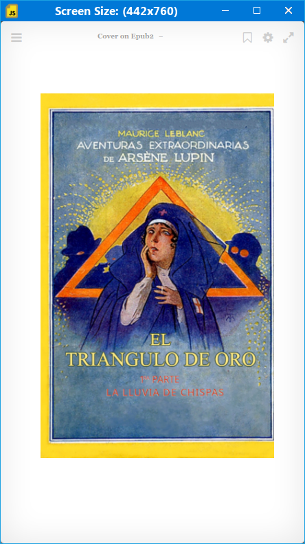

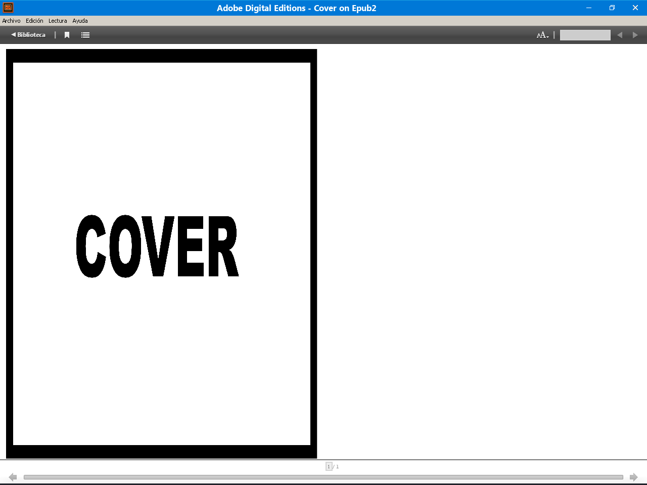

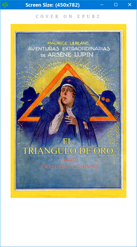

Old 12-14-2023, 08:06 PM   #13
RbnJrg
Posts: 1,938
Karma: 9699999
Join Date: Mar 2013
Device: Kindle 4 NT
Forget SVG. Not every ePub reading software will work with SVG. My way has the best chance of working.
That is not true; sorry to be harsh, but your code doesn't work. This is how it looks under:
Bibi Reader:
Name:	Bibi Reader.png
The cover is not showed at all.
EpubJS Reader:
Name:	EpubJS Reader.png
The right side of the cover is not showed.
Readium Reader:
Name:	Readium Reader.png
The cover is not centered, is aligned to the top.
And your code use as anchor the "height" property (height: 100%); so, what happens when the "width" of an image is bigger than its "height"? Because the properties "max-width" and "max-height" are not supported by ADE Legacy (ADE 2.x), it happens the following:
Name:	Landscape cover.png
ID:	205202 Click image for larger version
Name:	Landscape cover 2.png
The cover can't maintain its proportion. Conclusion: your code doesn't work. I'm wondering if you seriously tested it under ADE 2.x.
By the way, an ereader that does not support an svg wrapper is anything but an ereader.

EpubJS Reader:
Attachment 205199
Attachment 205202 Attachment 205203
You have to be doing something wrong. The cover should resize to to the full screen size. It does not vertically center. There's no need for it.
