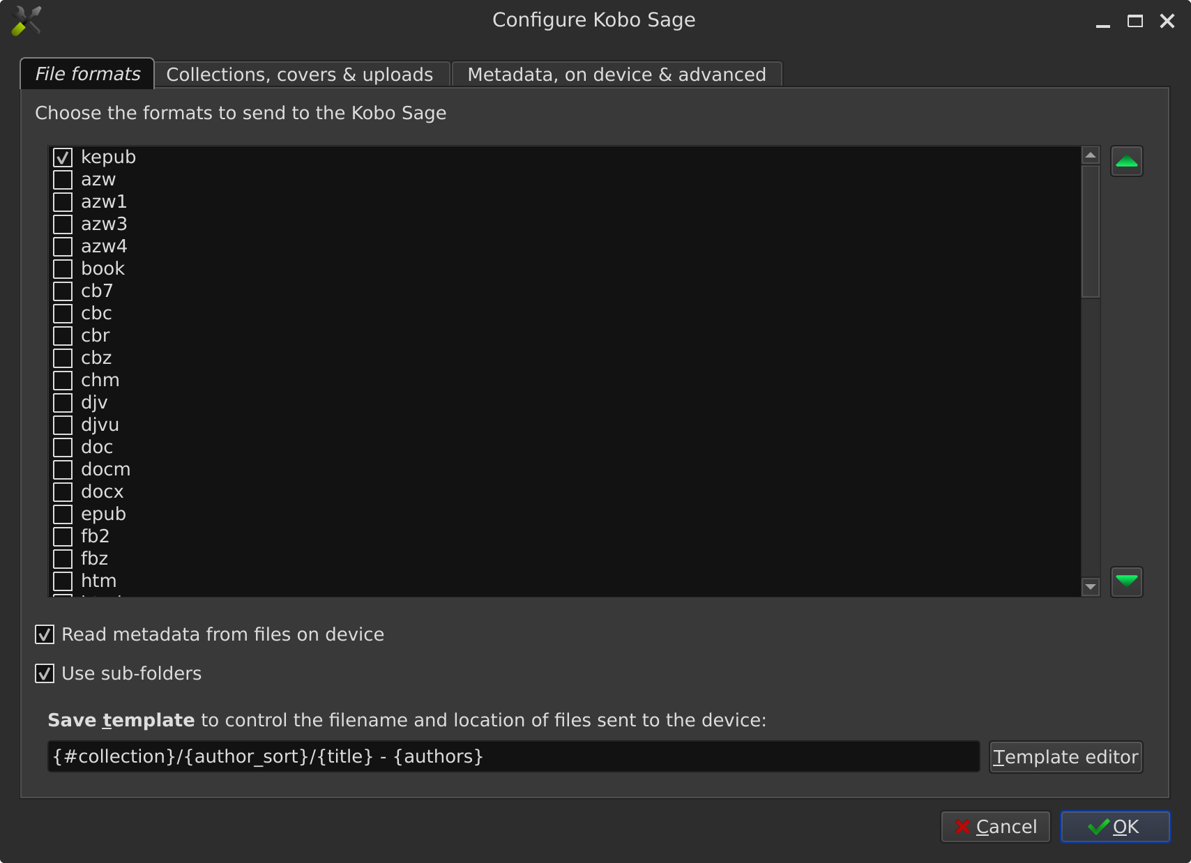

Calibre allows you to specify a template for how files are saved to an ereader. I use Kobo ereaders and I also have a column configured to as the collection of a book, so I modified the template as follows:
{#collection}/{author_sort}/{title} - {authors}
When I sent books to the device, it ended up creating garbled naming for the #collection directory names. For example:
chess
chss
coming
ecoics
econmics
economics
meir
memoir
military
self-imovement
I definitely don't have mangled collect names in the Calibre library. What's going on?

Interesting, upon further investigation, when it mangles the collection directory name, it also mangles the author directory name. But it does not mangle the epub filename itself. Definitely a bug in the app.

Your pathnames are being shortened to comply with all OS limits (AKA Windows)
Thanks, I just figured this out too when realizing all the mangled directories have filenames that are really long. That's it.
The shortening behavior is very counterintuitive. Directories are meant to organize and shouldn't be mangled. It doesn't help to have "chess", "chss", and "cs".
The filenames, on the other hand, can be since usually the title/author metadata is displayed on the ereader instead of the filename anyway.
Can this behavior be changed?

You might also want to change your template to shorten the author-sort and author fields. What I use is Elib/{author_sort:sublist(0,1,&)}/{title} - {authors:sublist(0,1,&)} where the sublistsublist(0,1,&) shortens the field to the first author name.
As for adding the collection name to the file path, since you mention the title/author metadata being displayed, why not simply add the books to a collection set in metadata on your Kobo ereader. See the second tab of the KoboTouch/KoboTouchExtended driver for the collections configuration.
That's an awesome tip, thank you.
I want to do this so that I can make sense of the books when viewing the directories. KOReader also.

This happened to me a few years ago:
I'm not sure if this would also be present with the regular Kobo driver.
I ran into a glitch where between the length of multiple (long) author names and the .kepub extension, the filepath seemed to hit some sort of limit and truncated part of my custom save path ({#kobopath}/{author_sort}/{title} - {authors}) , resulting it ending up in K:\Fanion\ instead of \Fanfiction\.
Thankfully I was able to fix it with a {author_sort:sublist(0,1,&)} to show only the main author, but I found it strange that it truncated the path instead of the filename. Did I make a user error?
The path creation is done by calibre. The drivers supply a maximum path length and calibre works something out in that. It does tend to shorten the actual file name more than the rest of the path, but, I have seen this myself. I use a couple of different libraries, and put the library name first. Occasionally the library name gets shortened. From a quick look at the code, all parts of the path can be shortened, but the longer the part, the more will be taken from it. Hence the file name part will usually be changed the most.
The original truncated path was exactly 180 characters (setting author_sort to a sublist shortened it to 156) and the filename did change quite a bit. If it had been able to display in full, it would've been 205 characters.
The driver sets the maximum path length to 185 characters. With it needing to remove 20 characters, I am not surprised the first directory was touched.
