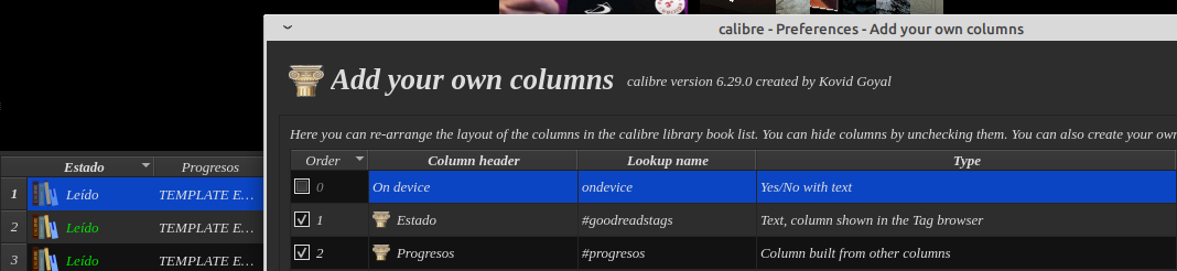

Old 11-05-2023, 10:07 PM   #967
dunhill
dunhill's Avatar
Posts: 934
Karma: 997336
Join Date: Sep 2017
I don't understand. What is the process column type? What is the status column type? Where does the result of the template go? What are the exact computation rules?
My status column is linked to goodreads and is updated with the goodreads sync plugin
What I am looking for is that if in that custom column that I have called #goodreadstags it says "Read" in another column where the reading process should appear, it tells me 100
The template should be in the custom column that depends on the result of #goodreadstags
I have tried
{#goodreadstags:'switch_if($ = 'Read', '100')'}
Old 11-06-2023, 12:31 PM   #968
chaley
Posts: 12,529
Karma: 8075744
Location: Notts, England
I have tried
Try this:
{#goodreadstags:'switch_if($ == 'Read', '100', '')'}
The comparison operator is ==, not =. The switch_if function requires a default that is used if there isn't a match. I added the empty string.
