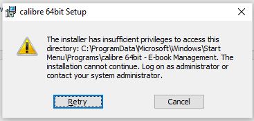

I can't uninstall, reinstall, upgrade, anything. I continue to get this error: the installer has insufficient privileges to access directory (see pic). I am the administrator - in fact, the only user on this machine. No issues with any other programs.

What happens if you run the installer as administrator?
Open an administrator command prompt and assuming that the calibre installer msi file is in your Downloads directory, at the command prompt enter:
msiexec /i "C:\Users\%username%\Downloads\calibre-64bit-6.28.1.msi"
A couple of other things to check are your antivirus settings and the security on the calibre2 directory to ensure that you have enough rights.

Same result
Permissions are fine on directory...but that directory (the calibre one following Programs) doesn't exist.

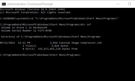

Note that the ProgramData directory in the root of your C drive will require you to show hidden files/directories before it will be visible. Once you have done that the path shown will be visible.
Open a command prompt and enter:
cd "C:\ProgramData\Microsoft\Windows\Start Menu\Programs\"
Typing dir ca* should show you that calibre directory.
Old 10-10-2023, 02:46 PM   #9

Still not there...and 'show hidden' is selected.

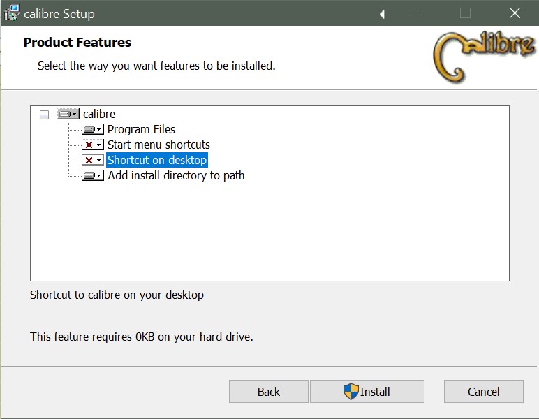

Start Menu shortcuts are an install time de-selectable option:
Name:	Screenshot 2023-10-11 083110.jpg
What version was previously installed?
Perhaps it was 32 bit, have a look in ==>> C:\Program Files (x86)
If it's there remove it.

Ran a registry cleaner - not sure it did anything. Same installation error. Installed (advanced options) and 'de-selected' the create shortcut menu and it installed. Thanks for the help everyone.

That would seem to indicate that the user used by the installer does not have the right to create the directory.
Out of curiosity, what happens if you try to manually create the "calibre 64bit - E-book Management" directory in C:\ProgramData\Microsoft\Windows\Start Menu\Programs\ ?
