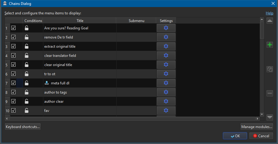

I just noticed that the menu icons for my Chains are not displaying. Any ideas on what to look into?

First thing is to make sure the icons are still there on your filesystem in the directory they are supposed to be in. Also are they only absent in the menus? I mean can you see them next to the chain name in the chains dialog? Can you re-choose them from the icon dropdwon menu?
Re-choosing doesn't seem to work.. This is what I see in the Chains dialog:
Name:	MWSnap 2023-09-30, 16_40_07.png
Oddly, I see there's one chain icon showing up (meta full dl), but it doesn't correspond to the one I have chosen, it's different..
edit: icons are located in C:\Users\user\AppData\Roaming\calibre\resources\im ages

Are these stock calibre icons? if they are not, when you try to re-choose them, can you navigate to where they are stored on disk? what happens next?
I added a new icon with a unique name, used Everything to search my drives, and the only place where this new icon is found is the above mentioned

Last resort here is to rename them by adding a numerical suffix as they might have name clashes with calibre stock icons. I've been meaning to re-write the whole icon management for a while now, so I am not inclined to put much time into icons, except for minor bugs. If there is any additional clue for me to investigate, let me know.

Old 09-30-2023, 05:08 PM   #1169
Comfy.n
want to learn what I want
Posts: 1,681
Karma: 7908443
Join Date: Sep 2020
forgot to answer: yes, I can navigate to where they are stored on disk.
I think I found something interesting: if I choose the file named download-metadata.png for any chain, this icon will show up in PI menu and in the Chains Dialog.
So it seems it doesn't like icons with filenames other than Calibre Stock's?
Yes, there has been a change in Calibre6/Qt6 that conflicts the plugin's way of managing icons. I haven't got around to dealing with. But I will sometime in the future.
