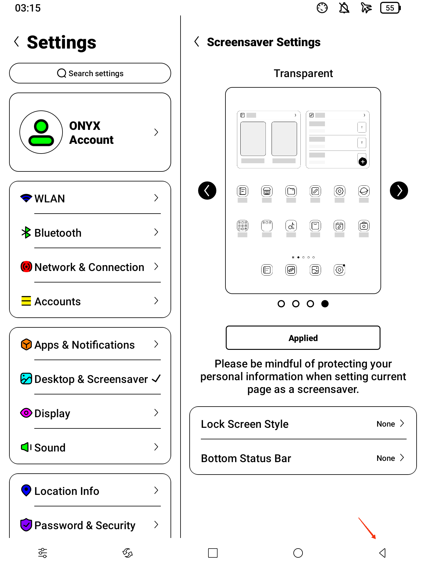

I did discover the screensaver and it's 'all-transparent' option by myself. today's world children's day is a holiday in my state. so I have a bit time to explore my new 'toy'.
suggestions for a good/better note taking app are welcome, btw.

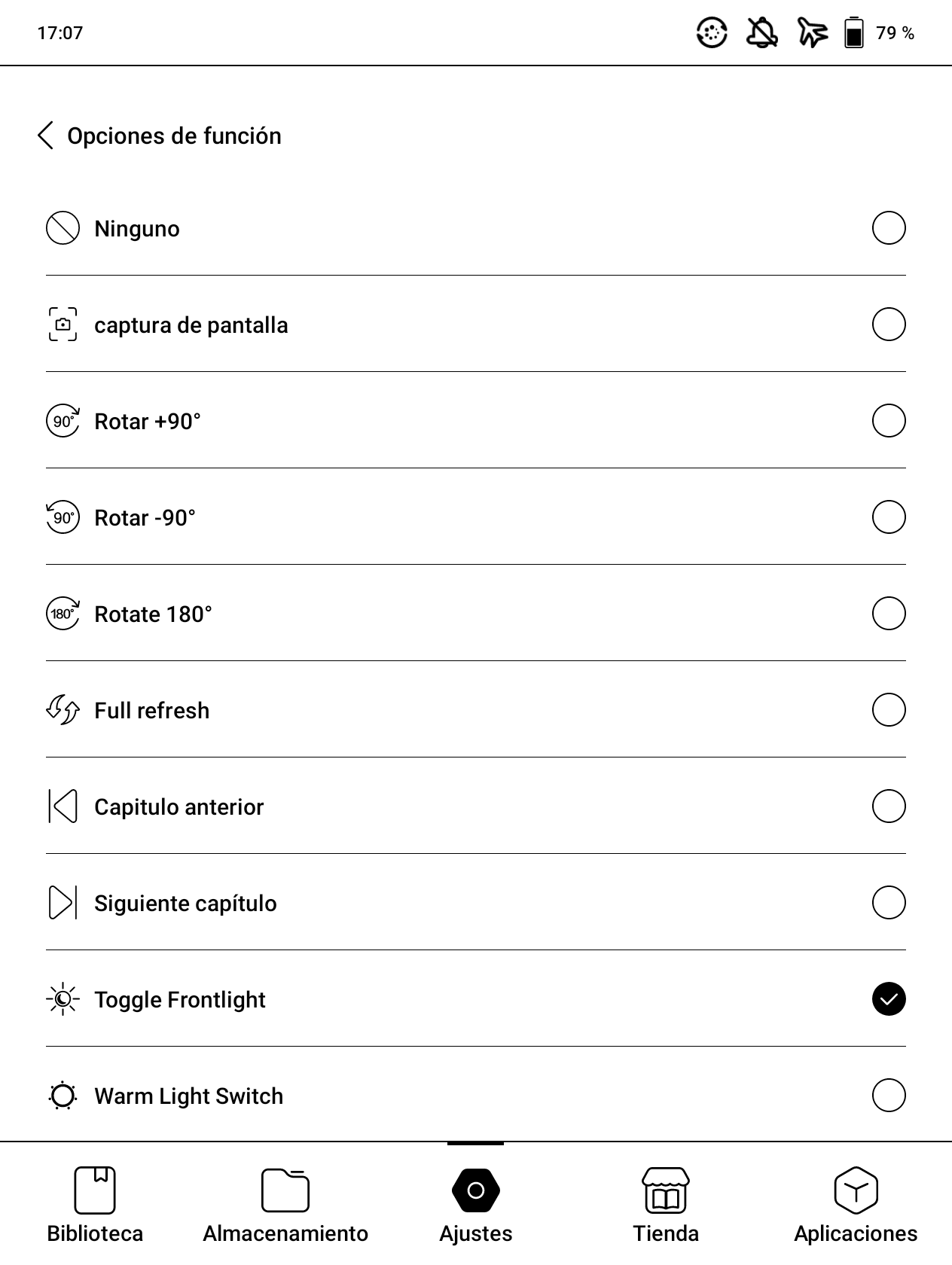

Originally Posted by OIX View Post
ohh, I read over this.
what do you mean by that ... has you device a Frontlight on/off gesture?
because the Nova Air C only offers these gesture bindings.
Attachment 203895
No, I was referring to the side gestures.
(This option is only available on Onyx devices with page turning keys).

Then set the standby screen properly.
Originally Posted by cellaris View Post
On the Tab Mini C you also have the option of the transparent screensaver, but I don't know if it is available on the Air C and if that would be a solution for you.
It is available on all Boox devices
