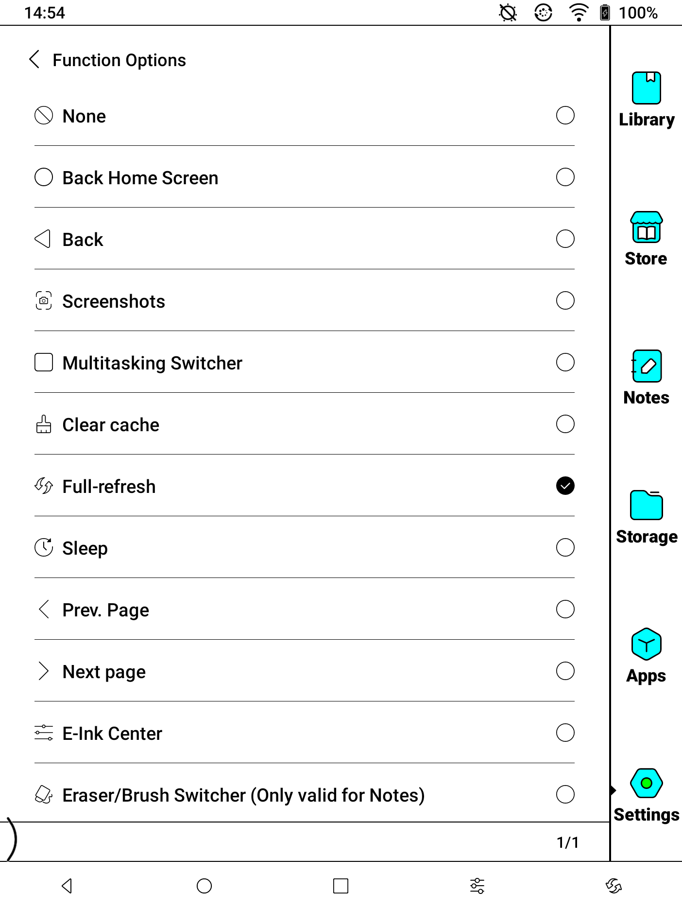

because the Nova Air C only offers these gesture bindings.
OIX is offline   Reply With Quote

Originally Posted by OIX View Post
ohh, I read over this.
what do you mean by that ... has you device a Frontlight on/off gesture?
Attachment 203895
No, I was referring to the side gestures.
(This option is only available on Onyx devices with page turning keys).
cellaris is offline   Reply With Quote
