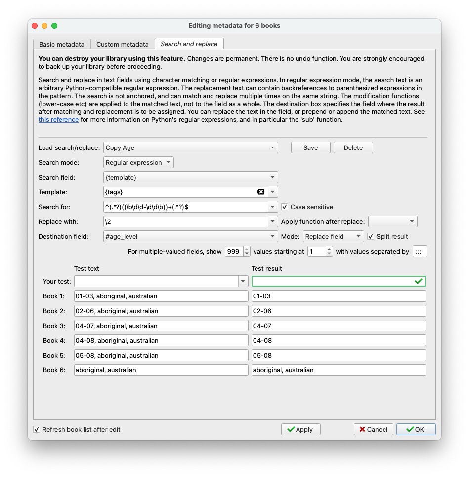

Thanks for your help. That is how I would expect it to work, but it doesn't. I am wondering if it is something to do with calibre's separator characters
See the attached screenshot if. Am I missing something?
Name:	Screenshot 2023-09-14 at 19.08.02.jpg

You can get around this by using *template as the input field, where the template is something like {tags}. The result of a template is a single value, not multiple values, even if it contains commas. This causes S&R to operate on the single value, not individual ones.
This works pretty well, however, if there is no age-level tag is copies the genre tags. Is there a way to prevent this?
My cave-man workaround is just to exclude any books missing age-level tags...
Attached is my config that mostly works:
Name:	Screenshot 2023-09-15 at 12.33.21.jpg

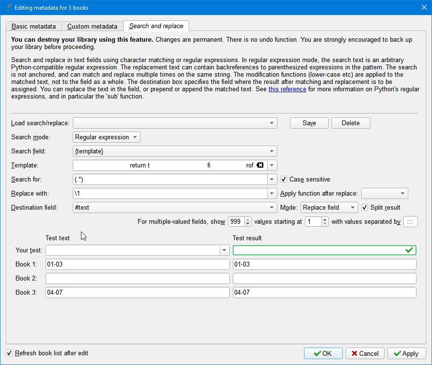

To avoid the pre-selection you need to "get fancy".
This works for me. It depends on the tag always being nn-nn with no other leading or trailing characters. It uses the first one it finds. If it desn't find any then it returns ''
The General Program Mode template is
program:
	for t in $tags:
		if "^\d\d-\d\d$" in t then
			return t
		fi
	rof;
	return ''
The S&R is
