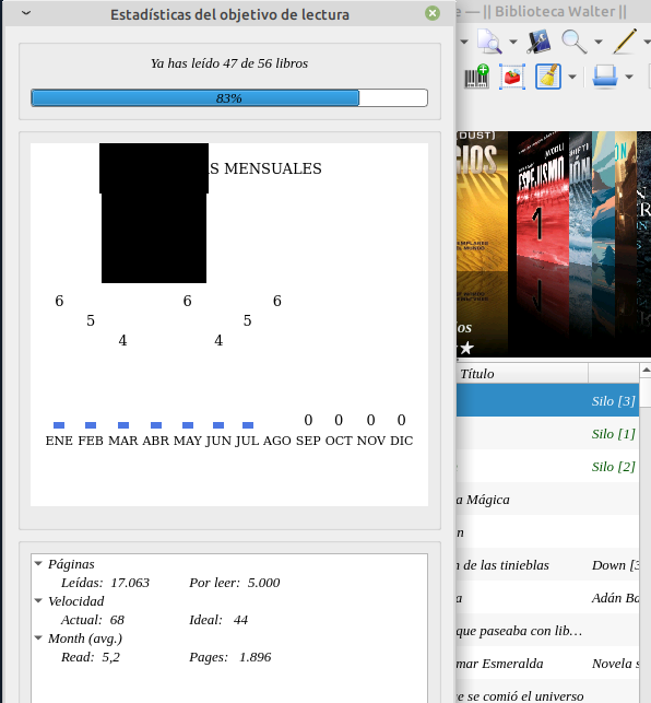

@thiago.eec I have problems displaying the bar columns in the statistics.
In Linux mint, as an operating system
