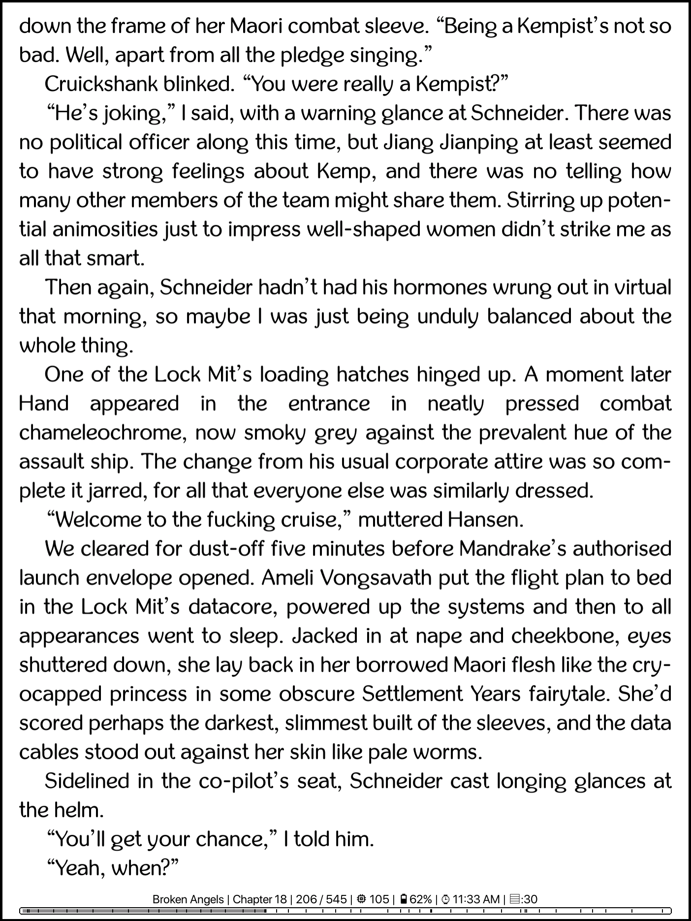

Here is the example of how it looks with 5px overscan around the screen. It just draw a black border.
KOReader shrinked down nicely, the bottom progress bar now doesn't affect the number of lines per page so much. So I was able to move its bottom margin from 1 to 5.

P.S.: “black” borders are only visible when taking screenshots. Screen itself just doesn’t start drawing most of the UI outside overscan values.

OMG, what are all those numbers at the footer. It would drive me insane.
5,5,5,5 is correct (in pixels).
Yes, I've seen that it just does a black border.
Probably a theme change could turn that to white.
