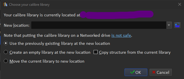

Hello, everybody!
I have two libraries - my book library and my knit/crochet pattern library. I had to do a Windows recovery/reset/whatever it's called yesterday, so Calibre doesn't 'know' about the second library yet. But, when I click on the "Switch/Create Library" I don't see an option that feels "safe" to me. With many many hours in curating both libraries, I'm a little terrified of effing up. I obviously must have succeeded when I created the second library... so what am I mis-reading?
Below the location bar, I see 3 options:
Use the previously exiting library at the new location
Create an empty library at the new location (option: copy structure from the current library)
Move the current library to a new location.
I just need to tell Calibre - hey, this library exists, too. Both libraries are in the same folder, if that helps. I couldn't find anything on keeping multiple libraries (note: NOT virtual libraries here) in the manual. As I said in another post today -- I'm probably just not seeing it (dialogue fatigue? Is that a thing? lol)
As soon as I figure this out, I'm adding it to my SOP for reinstalling Windows!
Anne

Click the blue folder button, browse to and select your pattern library, make sure the "Use the previously exiting library at the new location" radio button is pressed before clicking OK.

Both CAN NOT be in the same folder (unless you have them in a backup Archive and those are not technically a Calibre Library when in that state).
If you are restoring from a backup,
Just put them into 2 separate folders (side by side, but not merged)
Then use the Use Existing option to point at the first, then the other
The default (With 1 book) will still be on the list, You can remove that while using either of the others (just select delete: That only deletes the Switch list Entry)
