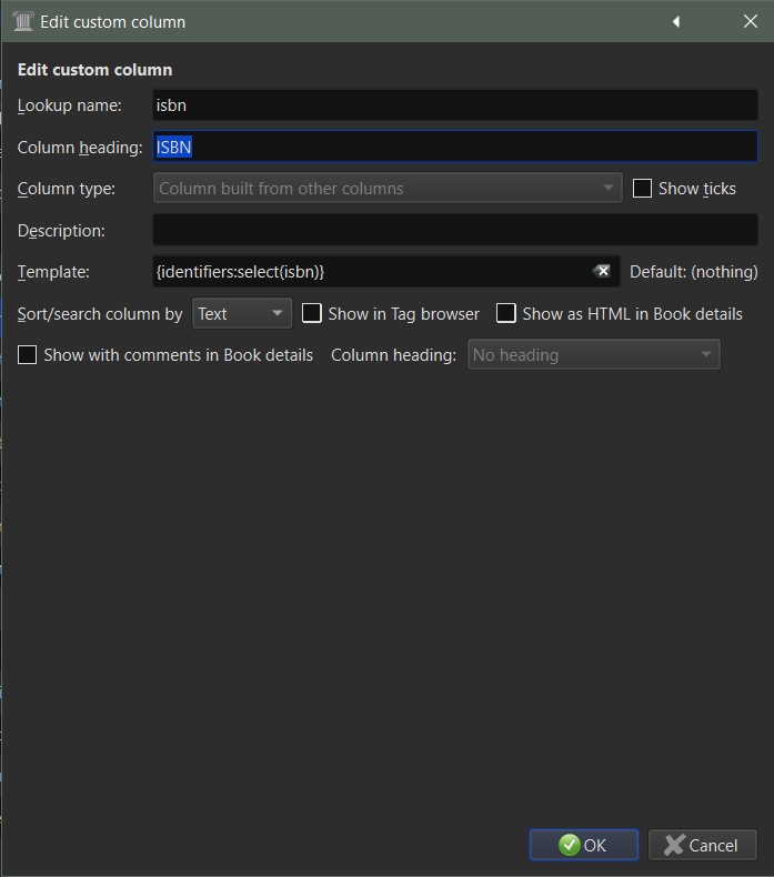

What didn't work - creating the custom column or sorting it?
This works for me:
Name:	Screenshot 2023-06-26 124448.jpg
{identifiers:select(isbn)}
This works for me:
Attachment 202299
thank you, this was what I was referring to. I guess I did something wrong, this worked for ISBN: tags

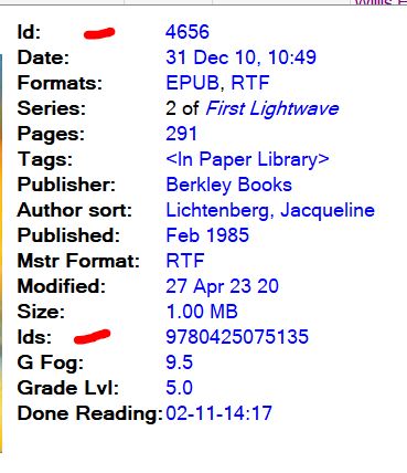

Wait up, this is getting confusing My first answer was because I thought they wanted the Calibre index # sorted
{id} is the CALIBRE index number seen at the end of a folder name
C:\Users\thedu\Calibre Library\John Schember\Quick Start Guide (1)
{identifiers:isbn} finds (catalog) Ids like ISBN
Kovid, can this label in details be changed to Identifiers, thus making it real clear which we are talking about ?

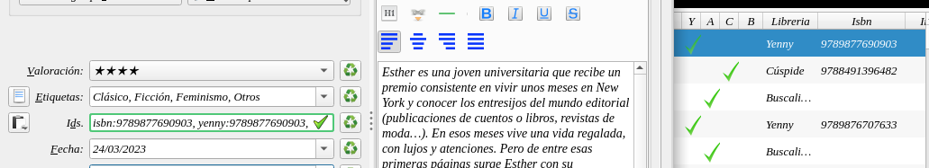

As indicated above, the isbn of a book varies if it is a soft cover or a hard cover.
What I do is assign an identifier according to the store that bought the book.
And in a personalized column according to the store, it brings me the corresponding isbn.
