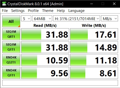

Edit: I did some tests with CrystalDiskMark on both the Clara HD and Libre 2 .
The write speeds for the last two rows are closer to what I get transferring many epubs. Although 2.7-3.0 MB/s is still the maximum I can get even if it's one large file (like a KoboRoot.tgz).
ID:	202021   Click image for larger version
