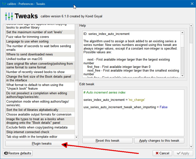

Originally Posted by un_pogaz View Post
Oh, I'm interested, I had used the template dialog and it took me a while to stop panicking about all the exceptions I had introduced in my code.
But how do I use it? I add "show_stack_traces_in_formatter = False" in any tweark configuration or I edit directly "tweaks.json" ?
Use the "Plugin tweaks" section. It is for tweaks that calibre doesn't know about, usually for plugins but also for "secret tweaks" like these. See the attached screen captures.

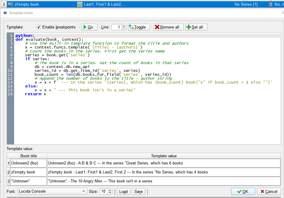

    context.funcs.name(arguments)
    For example, this python template uses the built-in template() function to format the title and authors. It then checks if the book is in a series, and if so appends the series name and the number of books in that series:
    python:
    def evaluate(book, context):
    	# Use the built-in template function to format the title and authors
    	x = context.funcs.template('{Title} - {authors}')
    	# Count the books in the series. First get the series name
    	series = book.get('series')
    	if series:
    		# The book is in a series. Get the count of books in that series
    		db = context.db.new_api
    		series_id = db.get_item_id('series', series)
    		book_count = len(db.books_for_field('series', series_id))
    		# Append the number of books to the title - author string
    		x = x + f' --- In the series "{series}, which has {book_count} book{"s" if book_count > 1 else ""}'
    	else:
    		x = x + " --- This book isn't in a series"
        return x
    This screen capture shows the results:

  • Breakpoints for Python templates in the Template tester dialog.
