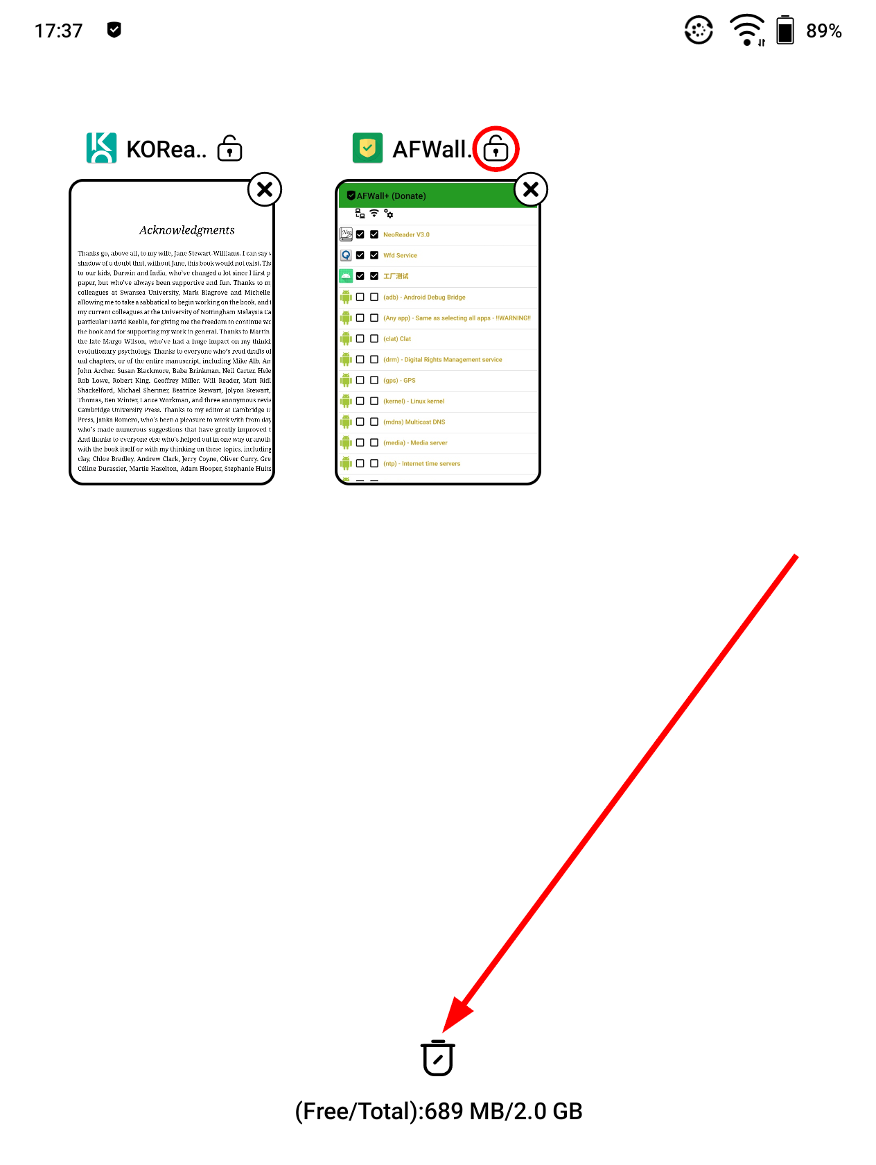

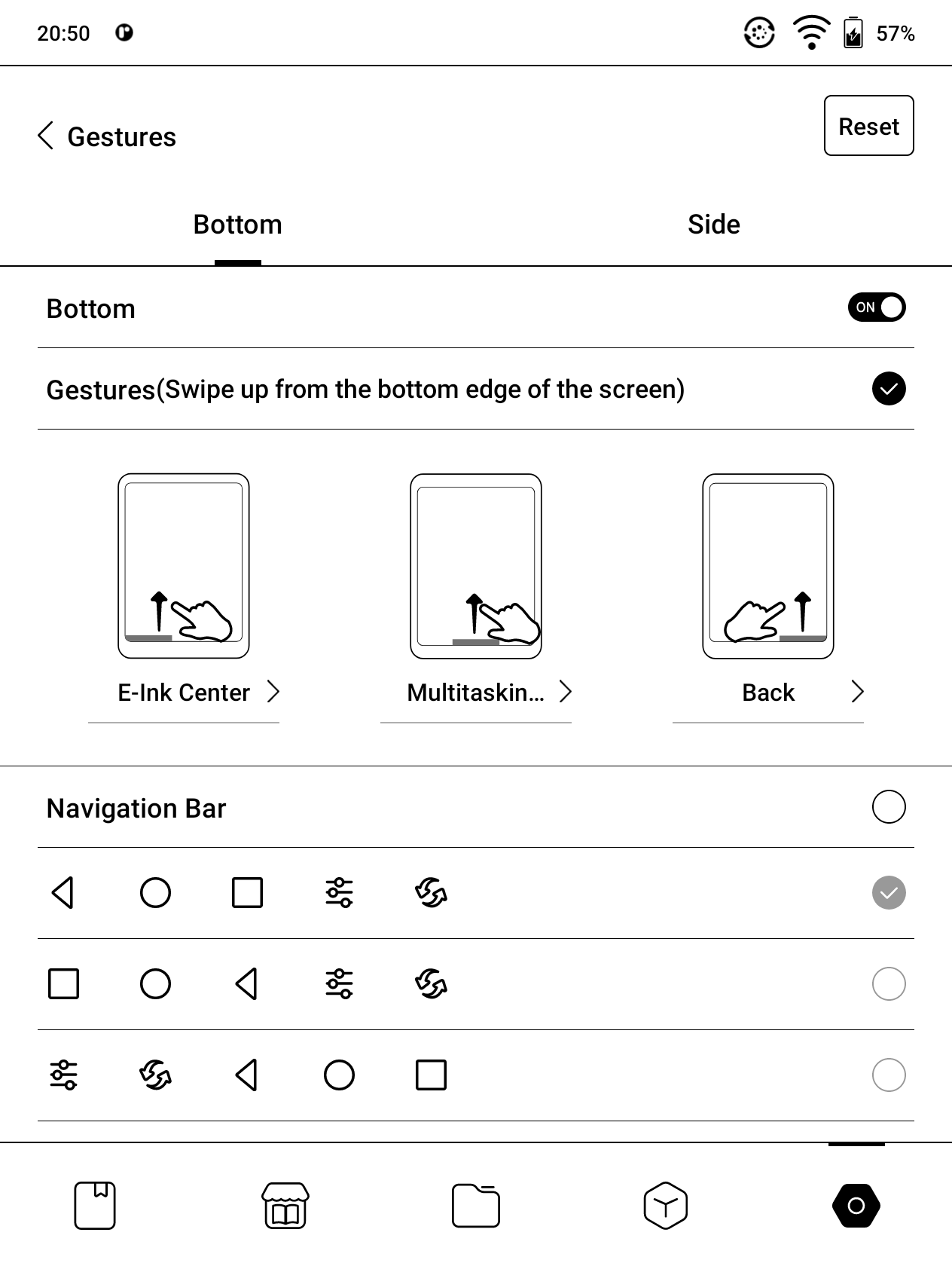

Old 05-10-2023, 02:56 PM   #120
denisuu
denisuu has learned how to buy an e-book online
denisuu's Avatar
Posts: 136
Karma: 98
Join Date: Dec 2018
Device: Onyx Leaf 2 (White)
Originally Posted by popej View Post
Thanks.
I haven't updated system yet. I don't know how to kill all apps, is there a possibility? Killing manually only AFWall+ works, but it is what you should expect.
I meant the gesture when swiping up (Settings.png) There must be a way to lock AFwall+? Why is there a lock icon next to the apps otherwise?
It would be nice to just be able to push the trash icon and kill all apps without it killing AFwall+.
ID:	201482   Click image for larger version
Name:	Multitasking switcher.png
