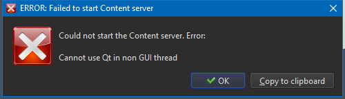

Just a heads up, in case this is relevant: I'm not able to start Content Server from current github source. Message is shown below:
Name:	MWSnap 2023-04-08, 19_15_16.png
I had an old archive from 6.7.1 source, so I tested running from that one and server starts fine..
Attachment 200887
I cant reproduce and I dont see how it could be caused by these changes. Something unusual you are running? plugins?
Hi Kovid! Glad you're fine today.
well, thankfully the first thing I tried after your reply was "Restart ignoring third party plugins", and that was it. Now I'm running from current source and able to start content server.

As for server not starting when running from current source, in my case, it *seems* related to Action Chains PI. But could be something on my end. I just use its basic actions/modules, so...

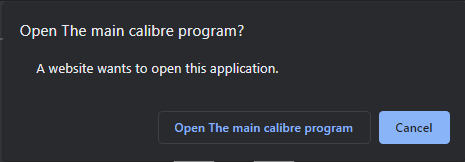

Name:	MWSnap 2023-04-09, 14_07_51.png

From a desktop point of view, what I can tell is that Windows sees Calibre's URLs and processes them seamlessly.
There is no reason to believe that the browser is running on the same machine as calibre. In fact the opposite would be normal, in which case opening a book details window on the machine running calibre won't do anyone any good.

From a desktop point of view, what I can tell is that Windows sees Calibre's URLs and processes them seamlessly. For instance, if I paste a calibre:// URL in the location bar of my system default browser (Firefox fork), this will bring to front Main Calibre window and execute the URL command, whereas the Chromium based browser I tested would ask "Open in Calibre?. (Video and screens attached)
OneNote is the same, I did this one to test the new calibre:\\book-details feature
Name:	Screenshot 2023-04-10 075139.jpg
