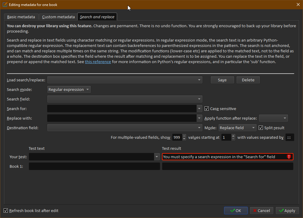

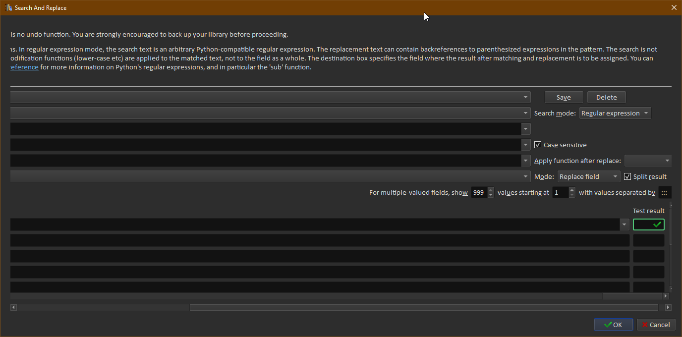

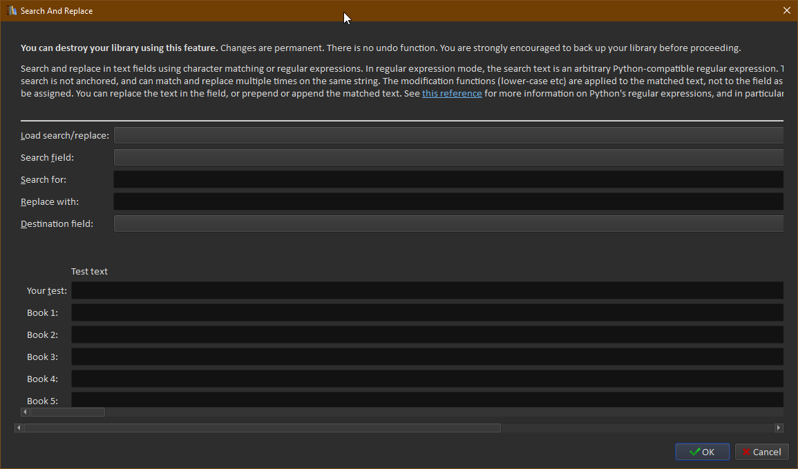

I'd like to make a single-field edit that changes series_index to '0' if a template returns true. However, series_index is not available for selection in the dropdown menu.
Are there other options or a workaround using the 'series' column?
EDIT: Search & replace may work.
ANOTHER EDIT: What's going on with the width of the dialog? lol
