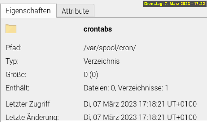

/var/spool/cron/crontabs/

@mariosipad
ok - seems to be empty

Did you remove the # ?
Then in terminal:
sudo ls -l /var/spool/cron/crontabs
mariosipad is offline   Reply With Quote

In terminal after your command appears:
huber70@raspberrypi:~ $ sudo ls -l /var/spool/cron/crontabs
insgesamt 4
-rw------- 1 huber70 crontab 1222 7. Mär 17:18 huber70
crontabs folder is not accessable, still contains nothing (see pic above)
