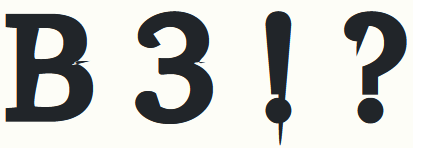

On the the weighted versions of ChareInk6 & ChareInk6P, there are quite a few visible artefacts as attached.
Any chance for a fix?
