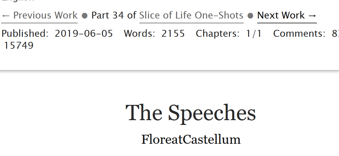

Also, I think there's a bug in downloading long series from AO3.
For example, when I download "Get story URLs from web page" the series https://archiveofourown.org/series/1344409 , the series numbers don't match with those found on AO3.
For example, 2 stories are downloaded with [74] in the series, and no [73]. Also, the series number that gets downloaded doesnt match with the one on Ao3. For example, [64] that gets downloaded by Fanficfare ends up being "Hangover", but in AO3, it's supposed to be number 65. And Fanficfare doesn't download 65 at all.
It also downloads 2 different stories and labels them as 67. One of those downloaded as 67 is listed as 68 on AO3, "A pint of bitter and a cider".
These are just some of the examples.
I was all ready to call you crazy, but for thoroughness sake, I downloaded the series. And sure enough, it's full of mis-numberings.
But it's AO3 that's mis-numbering them. See attached example of two stories showing the same series number.
I don't know how this would happen or how it could be fixed in AO3, but FFF can only use the data given it by the site.
I would suggest the Plugin Manage Series as an easy way to correct the series numbers in Calibre.
FYI, Unlike most sites that show, but block access to adult content, AO3 hides them entirely unless you are logged in. This particular series only shows 76 stories when not logged in.
I suggest you turn on the setting: always_login:true under [archiveofourown.org] in personal.ini. Note that leading '#' chars are commented out lines and should be removed:

Thanks! I just realised that the numbers when you open the story are wrong, but when you view it on the series page, it's mostly correct.
Seems like Fanficfare follows the numbers in the story itself, instead of the one on the series list.
