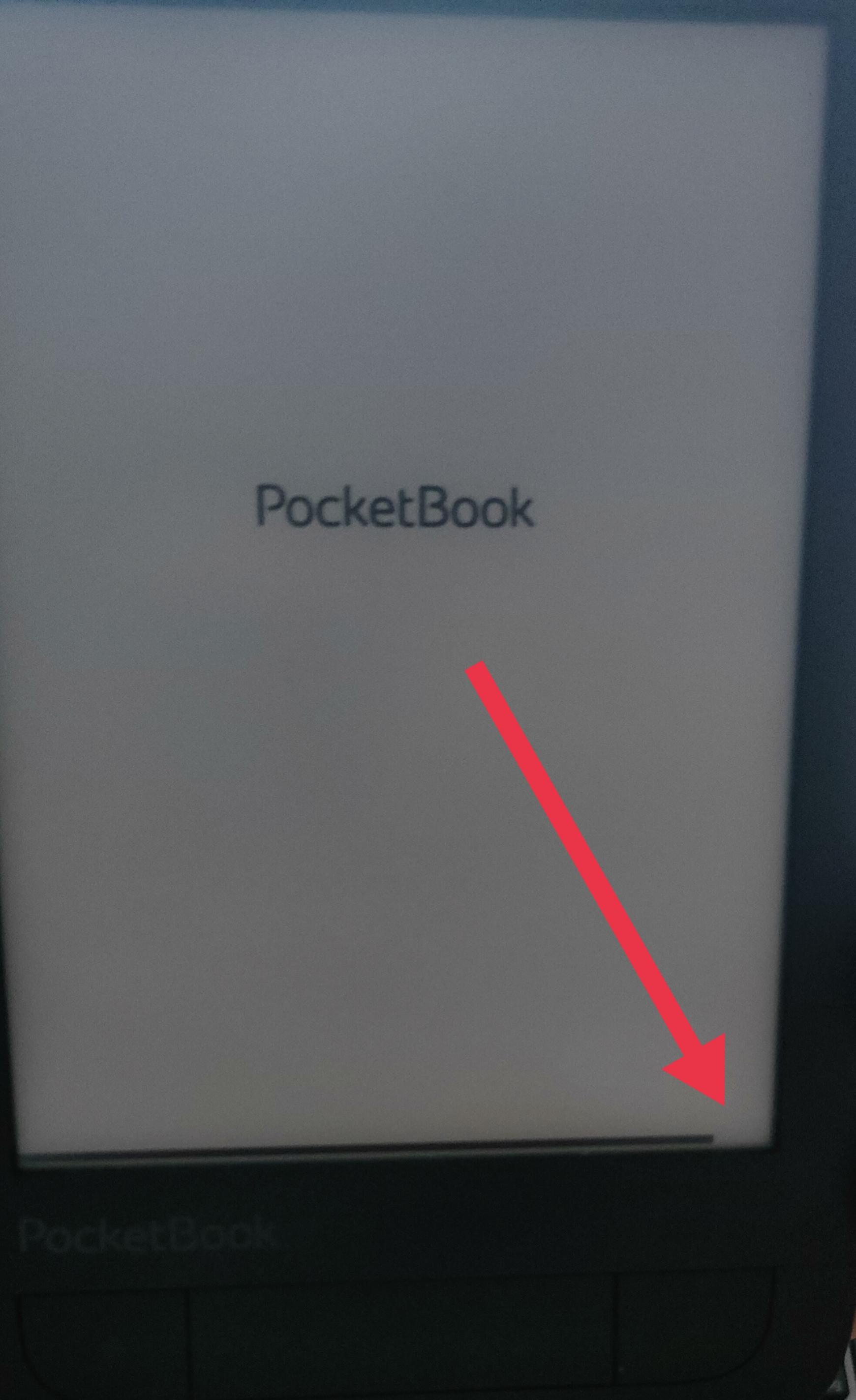

Hello,
My reader stuck on boot and I my idea how to bring it to live also. I replaced memory card, restore four partitions structure and fill it data which I restored from damaged card. Then I make update firmware with success. Then reader stuck on boot in place as picture. I connected serial port monitor to it and in attachment is what he said. I tried to patch monitor.app with new CID of card as tutorial on this forum but he still is the same place. What is the reason that boot log include some errors?

@rkomar:
I pretty much agree with you that this is crazy :-D
I am super new to that kind of stuff and probably simply underestimate the complexity. I figured that I might learn a bit about that stuff and try my best.
The problem is that i could not find a way (or person) to make an iso image for me, otherwise I would have used this solution with pleasure!
And also it is not even about the money, but more about sustainable world: the device is fully functional and it would such a waste of resources just to through it away...
I think I could prepare this image but first I must delete my private data from it. Does anyone know which data should I clean?

Originally Posted by sensi81 View Post
I think something is wrong with pubkey3.rsa key. That the private key used to sign does not correspond to the public key used to verify. Correct me if I am wrong.
You are wrong. TTS registration is hidden somewhere else in the secure partition.
I would greatly appreciate if you could do that!
Unfortunatelly I ahve no idea what is the private data you might have..
