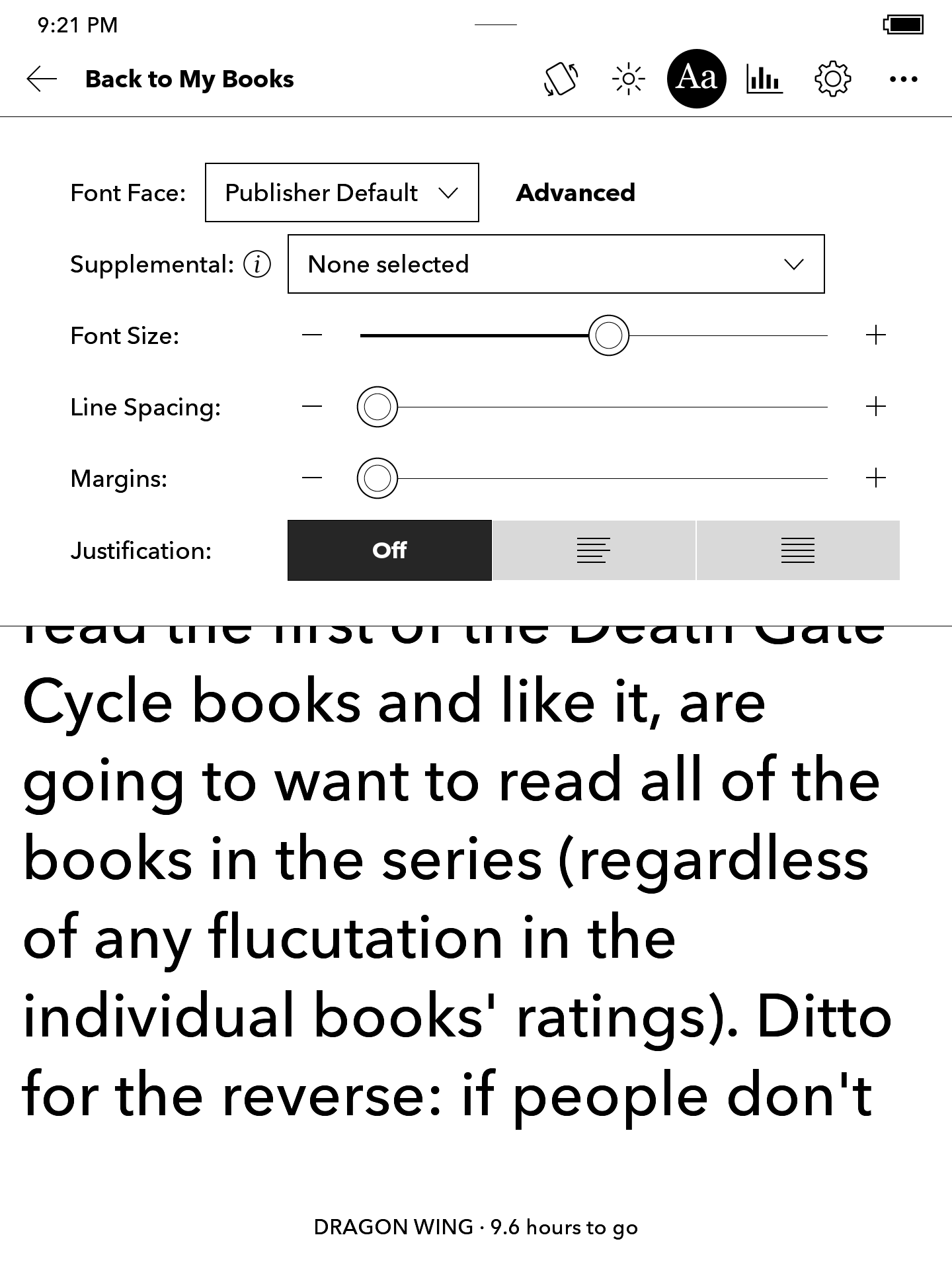

Three days later and it just happened again. I'd just finished a book (and the fonts were fine). I connected to Calibre and sideloaded some other books, properly disconnected, opened some totally unrelated book and the fonts were gone. As before, restarting the Sage fixed it.
The other thread here talking about this is also about it happening on a Sage. And, it just re-occured there, too.
Name:	20230215 -- Fonts Gone Main Screen.png
ID:	199759   Click image for larger version
Name:	20230215 -- Fonts Gone Font Face Dropdown Open.png
ID:	199760   Click image for larger version
Name:	20230215 -- Fonts Gone Supplemental Dropdown Open.png
ID:	199761   Click image for larger version
Name:	20230215 -- Fonts Gone Advanced Font Face Open.png
